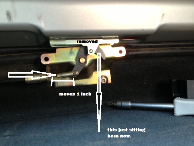

2. Figured the back latch is not opening. It would open maybe 1 inch and then stop. tried removed the latch with no luck as the lid was closed.
3. Figured I can get the roof to half open but either starting a calibration in PST2, or disconeting the gear using emergency open and pushing the roof out. (not sure how that would work if the fron latch wasn't working properly. I guess there must be manual override there too).
3.1 oh yeah the emergency procedure did not work.. i would go counter wise till I could go no more. full restistance and no movement on the back latch.
4. removed the trunk latching piece thinking maybe that is rubbing against it.. no luck...
5. the wire coming from the drive link looked little bend.. tried straightening it out.. not luck
6. removed the latch from the pivit screw thing maybe there is the resistance but no... so right now the link is just sitting on the back shelf. it still moves 1 inch.. but it won't complete the movement... if I could get it to somehow complete the movement at least I could get the top down and enjoy the nice weather... doing a bypass in the relay...

post-45366-0-77598800-1399856637_thumb.j
