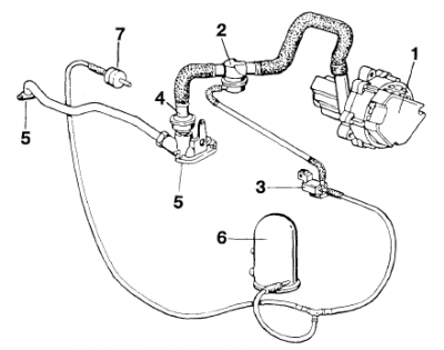

I checked all the hoses that I was able to see without taking anything apart for the secondary air injection codes with nothing out of place broken, etc.... I was using the diagram Ive attached. Now since this is a 2000 996 the Change-Over Valve is different (I learned the hardway). Part# 2 and 4 are combined now. Pump kicks on just fine.
Now going back to the second issue with the fuel system. Its making the wooing sound and when filling up the tank it clicks as its full and its not. So in that case for sure it would be the Fuel Vent Valve right?
