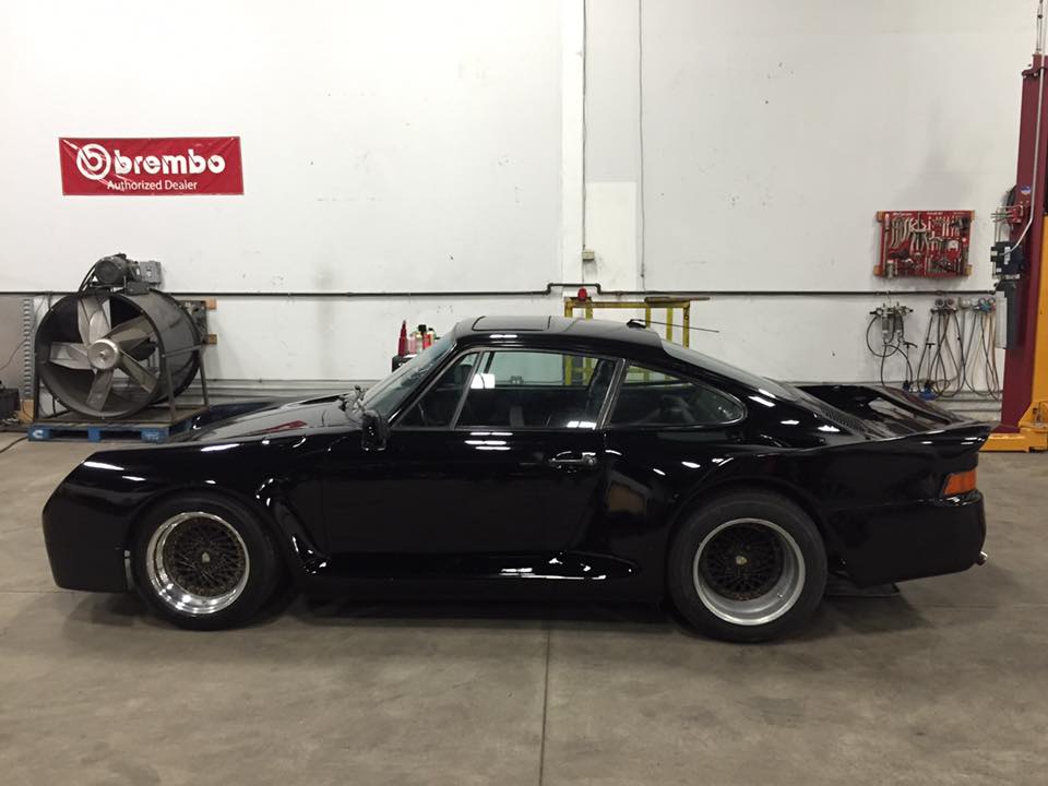

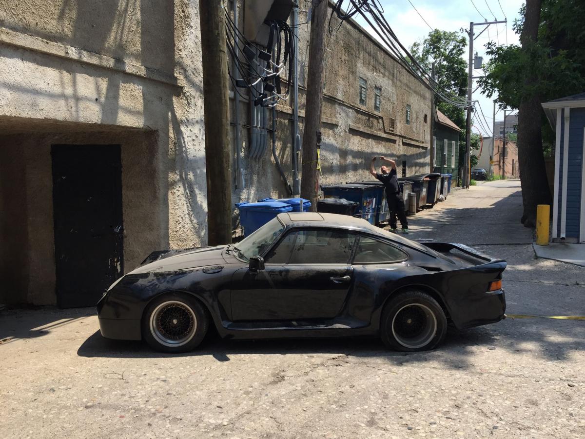

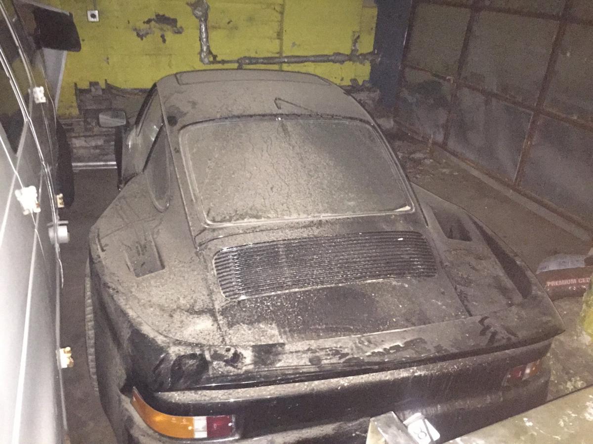

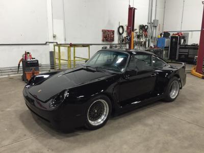

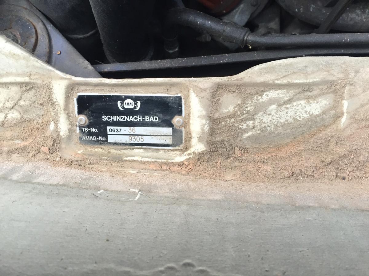

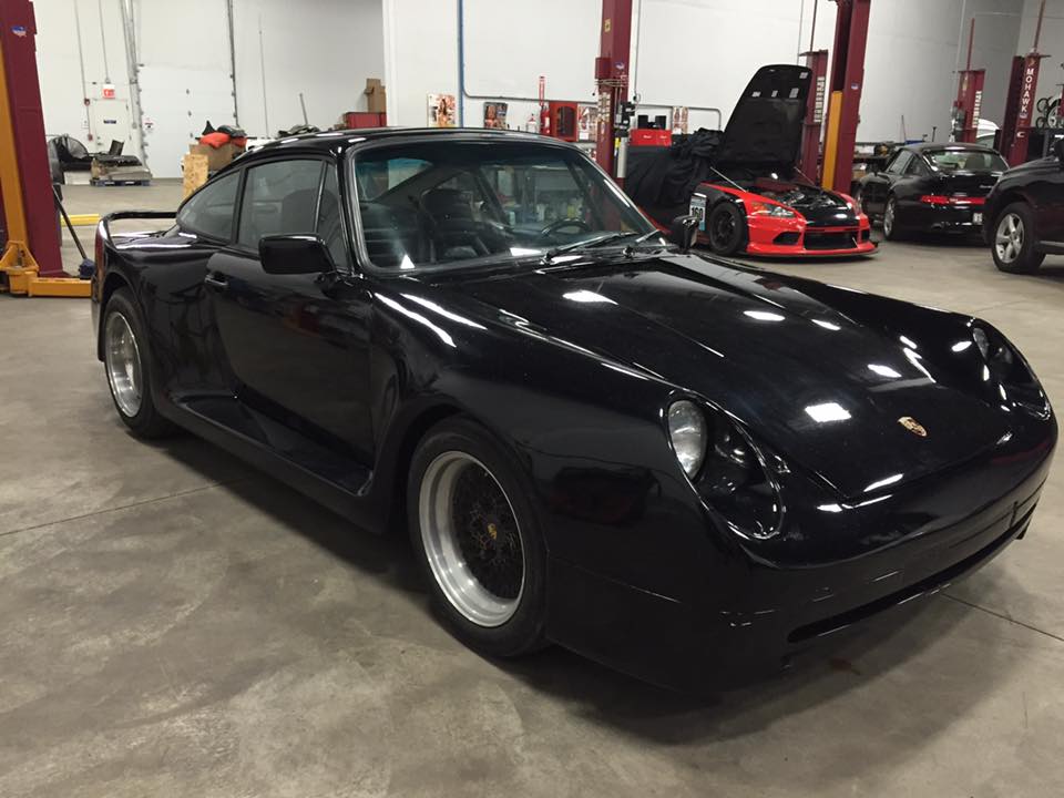

attachicon.gif1.JPGI just got my first Porsche 911 930Turbo 1976 euro,
Vin# 9306700661
Engine# 9011061015R
Any info about this numbers will help me.If engine is original,what type of engine is this.
Is that the engine number on the engine case?
If so, then it is likely a rebuilt from another (earlier) case - nothing wrong with that but without further images or even some internal examination it could have rebuilt as almost anything (from 1970 -1980's vintage).

yes that is a number on a engine case
