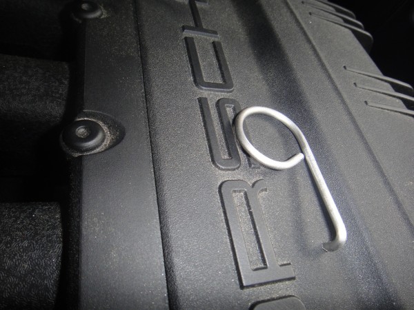

Not sure how but I broke the clip connects the wires to the top of the coil.  I  used the tool but instead of releasing the part that the bending tool pushes against broke.  Wire harness didn't release so I am okay for now.

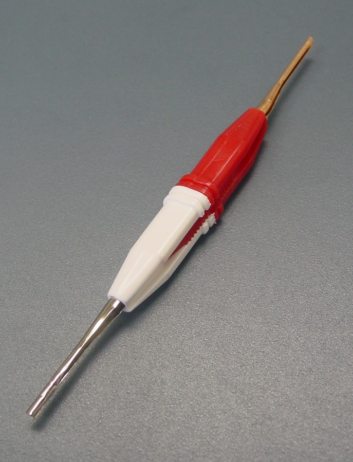

Not really sure what you did here, but there is no tool required to disconnect the electrical lead from the coil packs, just a tab you depress with a finger is all it takes.
If you are now trying to replace the broken harness plug, you will need a pin extraction tool (slides over the plug pins and depresses a small barb on the pins so they can come out of the back of the plug).  Tools look something like this:
