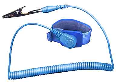

When working on or around air bags, caution needs to be your main concern, at close range these things can really hurt you.  Power down the system by disconnecting the battery, then waiting several min. before starting.  Never work with the air bag facing directly towards you, stay off to one side, make sure you are grounded before touching any air bag connectors so that you don't static discharge into the system accidently (we like to use grounding wrist straps to prevent this).
