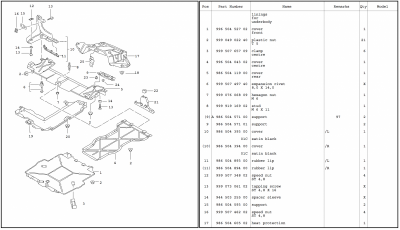

I was looking for some guidance for the fasteners for the rear underbody shield/cover.  I got my car up on stands (first time under the car myself), and discovered the rear underbody shield is completely gone.  (I am assuming my horrible mechanic broke it and never replaced it, one of the many reasons I am now working on the car myself).
I know that I need:
# 5 - 986 504 119 00 - Rear Underbody Shield/Cover
#2 - 999 049 022 40 - Plastic Nuts x2 (one per side)
#6 - 999 507 497 40 - Expansion Rivets x2 (one per side)
#7 - 999 076 068 09 - M6 Hexagon Nut x1 (for the center stud, I need to check but I believe it is still there)
Not Sure How Many of these are needed for just the rear cover?
#23 - 999 591 699 02 - B4,8 Speed Nut x4?
#13 - 999 073 061 02 - Tapping Screw ST 4,8 x 16 x?
#14 - 944 503 255 00 - Spacer Sleeves x?
The mounts for the cover are also very chewed up and I would like to replace them, can anyone confirm the part numbers/quantity?
#9 - 986 504 571 01 - Cover Support x2 (same for each side?)
#24 - 999 084 212 02 -  M6 Nut x4?
