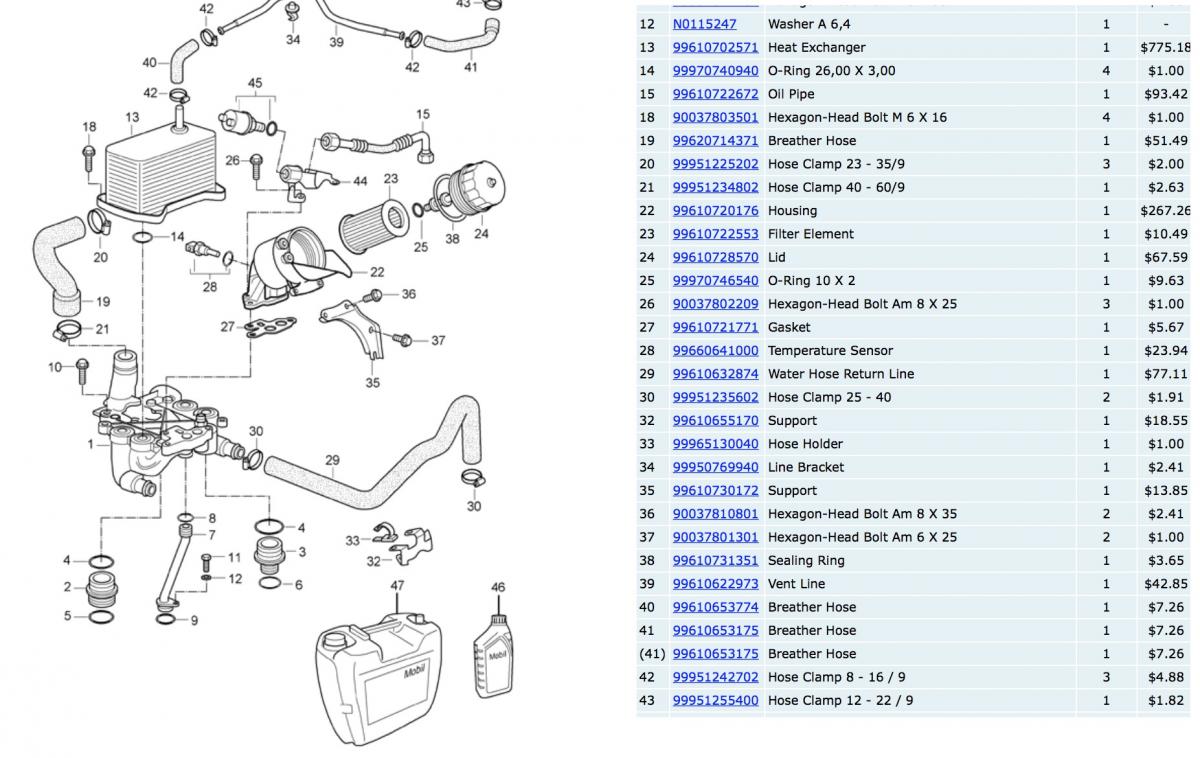

Does anyone know the o-ring size for the smaller o-ring used with the oil filter for the 996 TT? I have an oil filter from my C2, but it only has the larger o-ring included.  Porsche does not offer the smaller o-ring by itself.  It only comes with the filter purchase.
The part number is sold separately and retails for about $6.  http://www.sunsetporscheparts.com/oe-porsche/99970746540
Inside diameter...So the outside diameter is 10 + 2 + 2 about 14mm.....
