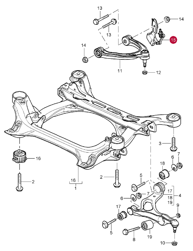

Every part number I find it says for cars with air-suspension. Are the level sensors the same for cars with air and without?
Headlight (only) level sensor is used on cars with standard suspension.
For your 2004 Cayenne S with standard suspension:
955 341 371 01 Headlight leveling sensor -- US MSRP $18.13
