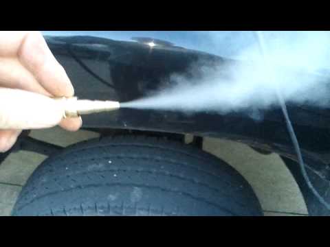

Running a smoke test for vacuum leaks requires a smoke generating machine and attachements:
These devices produce a very small stream of smoke that passes through small wand attachments that can be run along vacuum lines and connections while looking for the smoke stream to suddenly disappear, indicating a vacuum leak.  Unfortunately, these systems are not inexpensive, but can sometimes be rented.

Neither, running, the smoke machine generates a thin plume of smoke that passes thru one of the attachment's that is slowly moved along the vacuum lines and connections until you see the smoke get sucked in.
And before you ask, yes, smoke tests are time intensive.
