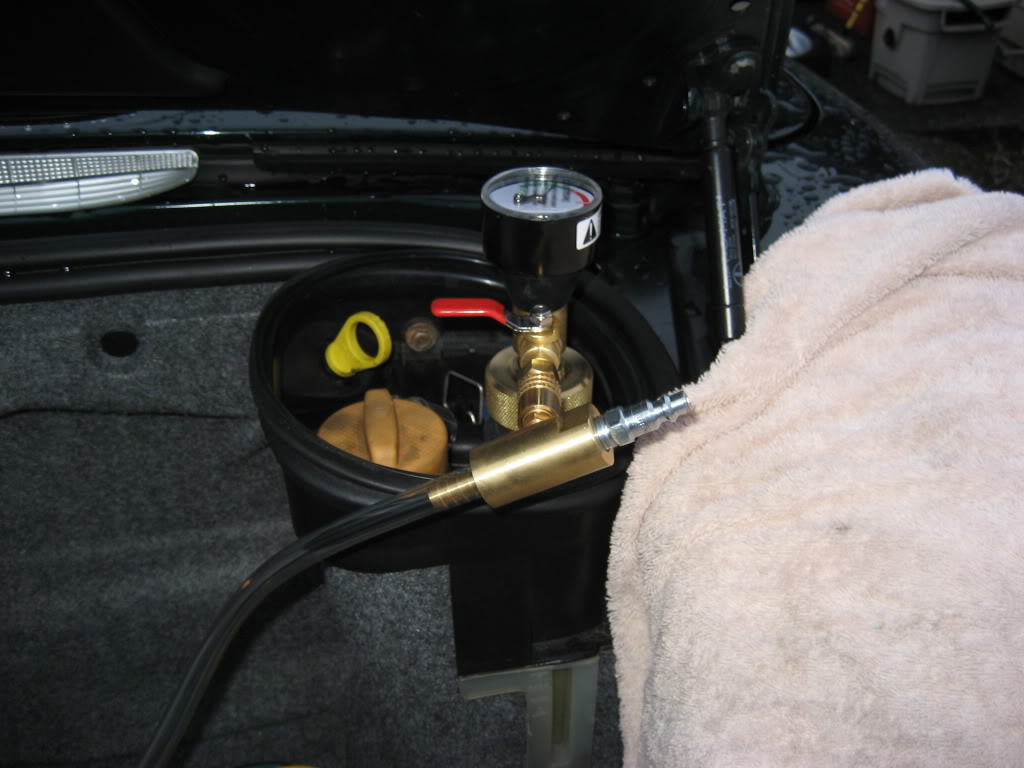

Yes, you'll be fine.  I use the UView Airlift system and have a small compressor of  3 gallons.  The key is it must be able to reach about 100 or so psi.   I run the compressor until the pressure starts to drop, then turn off the venturi vacuum valve and allow the compressor to recharge.  I repeat several times until my UView gauge is in the green or about 24-26 inches.  Then once charged make the switch to add the coolant.  I've filled about 10 cars with my small compressor.
I pre-mix the anti-freeze in a five gallon bucket.  I agree with JP and only mix 4 gallons.  2 of antifreeze and 2 of distilled water.  The plastic tubing used as the fill tube will want to curl up so I zip tie it to something to hold it down in the bucket. And depending on how much old coolant you where able to remove, you may have to tip the bucket and place the fill tube correctly to get only new coolant out of the bucket and no air.

Using the ULead Airlift 5500 on MY98
