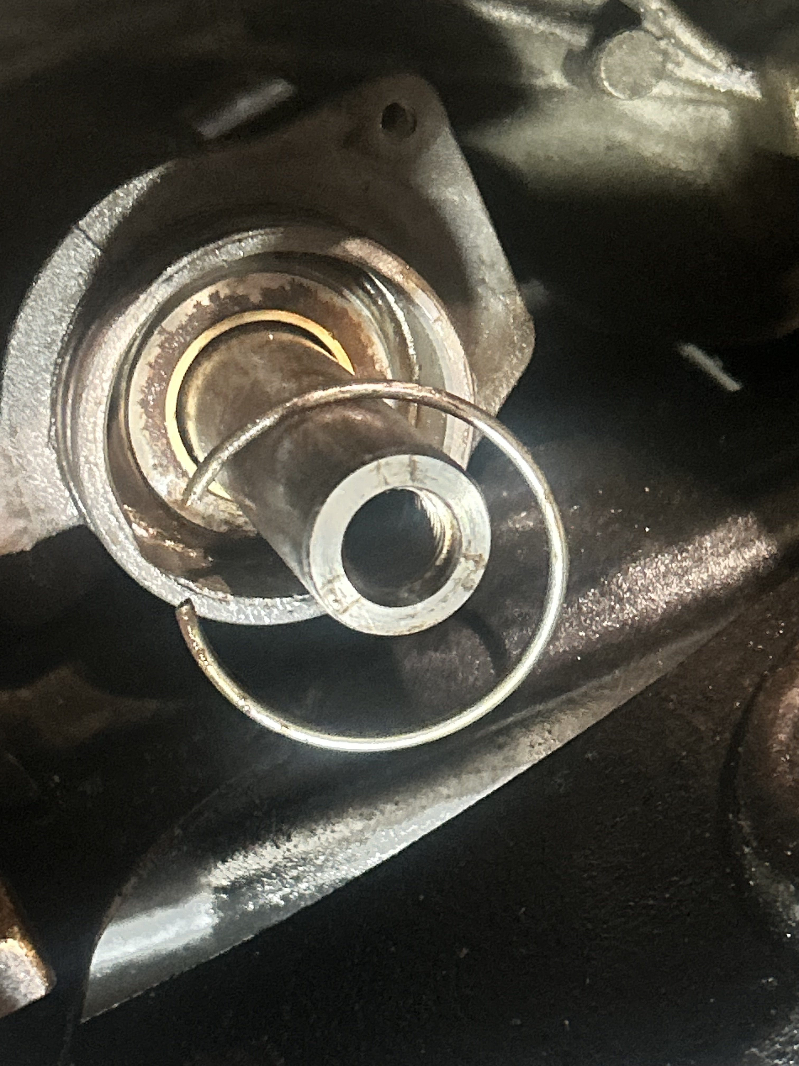

I achieved the removal of everything last night in about an hour. It’s not too bad of a job. The trick to getting the C-clip out is to clean everything up really good and then spin the clip so one of the ends is close to the groove. Then use a flat blade screwdriver and hammer it in until the clip starts to pop out. Work your way around to get it completely out.
You then have to work to get the metal cup out. I used two flat punches to wiggle it out slowly and someone in the drivers seat wiggling the steering back and forth. Get a bucket cause the power steering fluid will leak out when removing the cup.
The seal itself is 1-1/2 x 1-1/8 X 5/16. I haven’t put it all back together but I did get a few pictures along the way.
