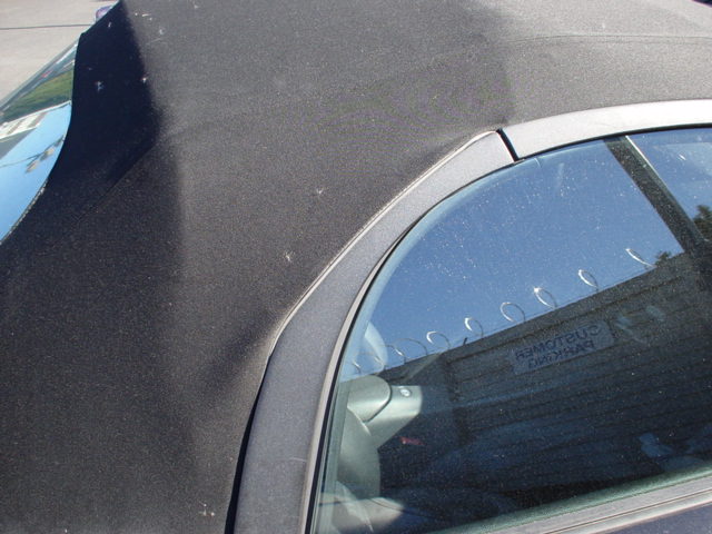

I recently had a new top put on my 2000 Boxster. I have begun to notice that occasionally when putting the top up that on the drivers side the top goes to the outside of the black molding that runs up the end of the window rather than on the inside. I spoke with the guy who put the top on and he mentioned that there is cable with a spring on each end that "pulls" the top in so that it will go on the inside of the molding and indiacted that it might be possible to adjust that or to replace the cables. Does this sound rigth to anyone?
Thanks.
Your guy is right.  There is some kind of spring and the tension needs to be checked.  Porsche issued a TSB in 1997 about this.
I got it back today and he showed me the "spring" and had the TSB. He turned it over to get more tension and greased an area that rubs and it seems to be fine right now.
Thanks for the feedback!

Hello,
I have had my top replaced and after the replacement it had exactly this problem. I checked the spring and they do seem not tight enough, I am confident that will be my solution so I'd like to thank ToolPants for puting up the picture, I didn't really know how to describe the problem and it showed so clearly what I had that I went right away to get the information in the TSB
