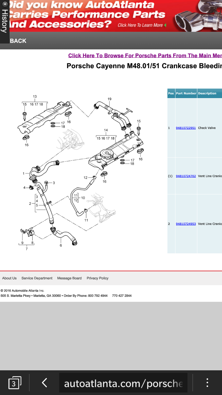

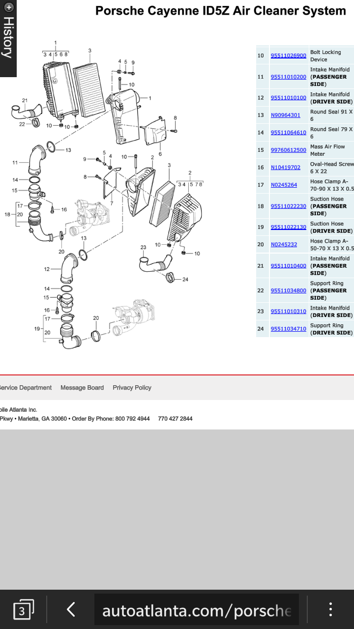

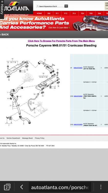

I'm assuming your referring to the pipe number 2 or check valve number 1 in the second pictured diagram? Which plugs into the back of the  suction elbow number 19 in the first pictured diagram?
There is no screen or media I know off in them pipes to catch debris.
I suggest you don't start the engine and remove carefully pipe 19 (if your careful no bits should have reached the turbo yet, they should be stuck in the pipe bend) and clean everything thoroughly, you do not want plastic going through your turbo impellor! Have you seen the prices of parts............ spare a few hours and address the issue is my advice.
Remove the air cleaner entire box for better access.

Thanks for the reply!  Definitely not what I wanted to hear.  The vents that need to get cleared are 16 and 30.. I can most likely disconnect 16 and move it enough to get some pressurized air to blow through it, however number 30 connection is right under the turbo and it will be very difficult.. I guess this is what I have to do.

My understanding of the system..........
The valve covers have a vacuum pressure which is balanced between bank 1+2 by a connecting pipe part 19 which has a small pipe which runs down to the back of engine  T and then to each turbo vent oil collection point via those rigid metal pipes.
Therefore the vacuum is sucking (venting) the oil vapors from the turbo (obviously very hot around the turbo lubrication creating vapors which need condensing back into a liquid) up into to valve covers. Then the AOS part 14 (which is mounted on the bank 2 front end 10cm diameter circle black cap) separates the oil and air allowing oil to drain into bank 2 head whilst the air is sucked past the 3 way check valve part 1 into the bank 2 turbo inlet during acceleration via pipes 2+6. This point at the AOS is where you could install a Catch Can as some turbo car owners have.
So if this theory is correct the plastic bits won't actually go inside the turbo inlet or exhaust turbines but could get either logged in the oil collector and possibly block/restrict oil flow to the turbo, or block the venting vapors, or get blown/suvked up into the valve covers and floating around in the valve train.
