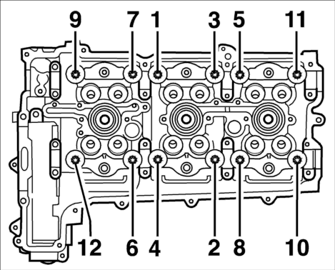

Screw in 12 M10 Torx screws evenly and tighten according to the prescribed tightening sequence -1-12- . → Initial tightening: 22 ftlb. , loosen all screws in reverse tightening sequence; → Initial tightening: 15 ftlb. ; → Final tightening, 2 x torque angle: 70 °

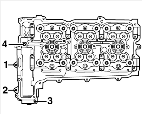

Screw in and tighten four Torx screws with M6 x 30 captive washers (10.9) -1-4- at the chain slot. Use of a magnetic bit is recommended so that the screw to be fitted in the slot -item 4- cannot fall into the crankcase. → Tightening torque: 9.5 ftlb.
