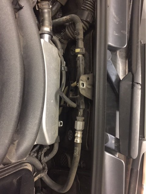

The fuel pressure test port is under the engine cover (which needs to be removed). step.  Once you have the cover off, the "fuel gallery" is the y-shaped tube (carries the fuel around the injectors) that runs on both sides on the intake manifold. It's the only silver metal tube there. On the very front ends of this y-tube, you will see black twist-off covers (similar to those found on a tire valve stem). Remove these and you can access the relief valves (they look like the inside of a valve stem). off, the "fuel gallery" is the y-shaped tube (carries the fuel around the injectors) that runs on both sides on the intake manifold. It's the only silver metal tube there. On the very front ends of this y-tube, you will see black twist-off covers (similar to those found on a tire valve stem). Remove these and you can access the relief valves (they look like the inside of a valve stem).
The caps in your second picture are the AC lines.
Just an update.  I wasted probably a day total trying to test the fuel pressure.  That port needed an adapter to fit the Autozone kit.  Then the Cayenne wouldn't stay on running long enough to check the pressure anyways.
