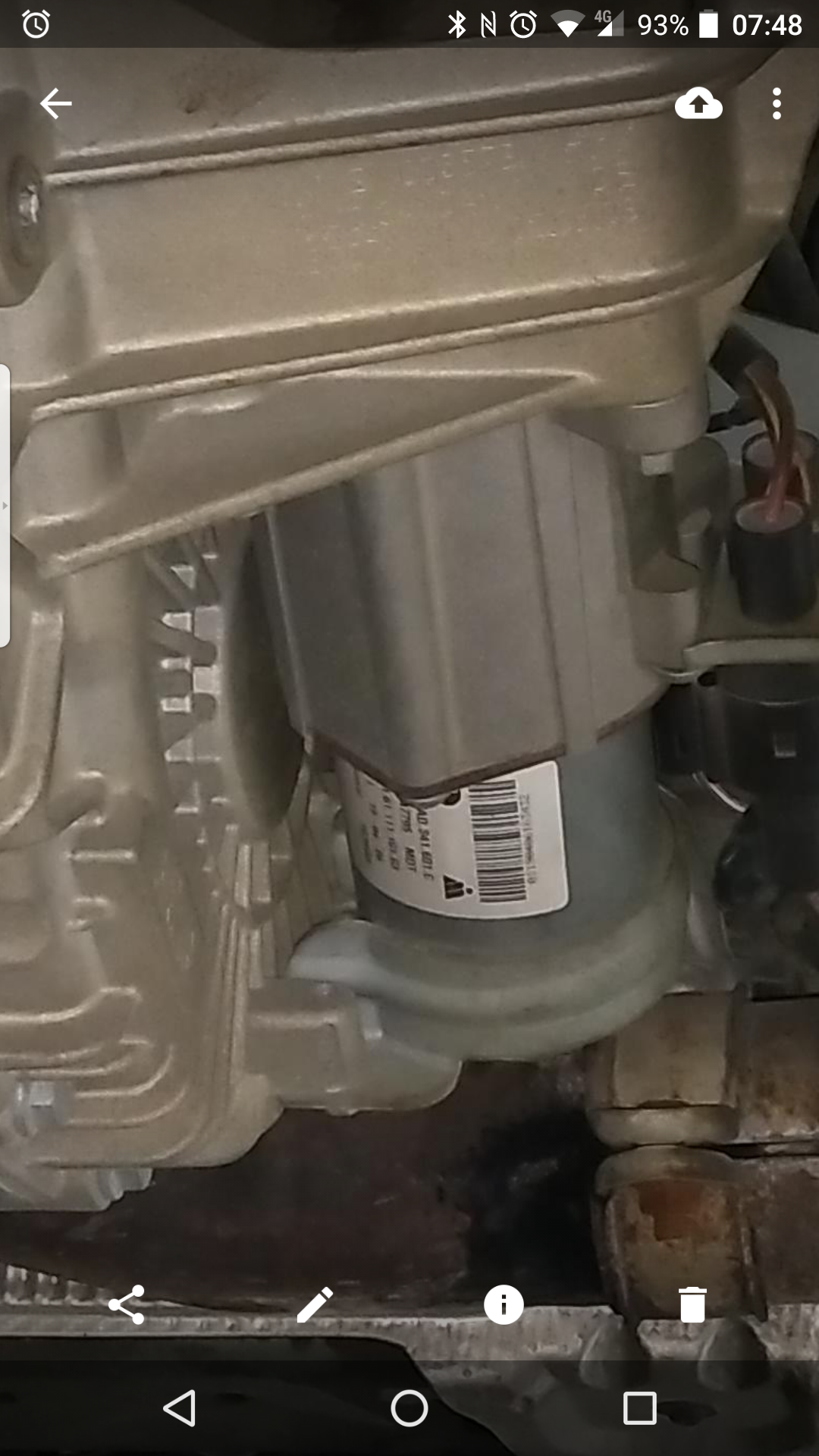

Under hard acceleration Im getting a jerky sensation as if a plug or coil is bad. Occasionally this will be followed by a 4WD malfunction and PSM being disabled. I tried to get the codes read but the 4wd and PSM malfunction reset after each key cycle so the car had no stored codes(at last not codes that could be detected with an Oreilly OBD2 code reader).
I pulled the plugs and they looked fine as did the coils and i'm also not getting any misfire codes or CEL.
Has anyone had these issues? Is this transfer case stepper motor malfunction? control module? or a new T-Case?

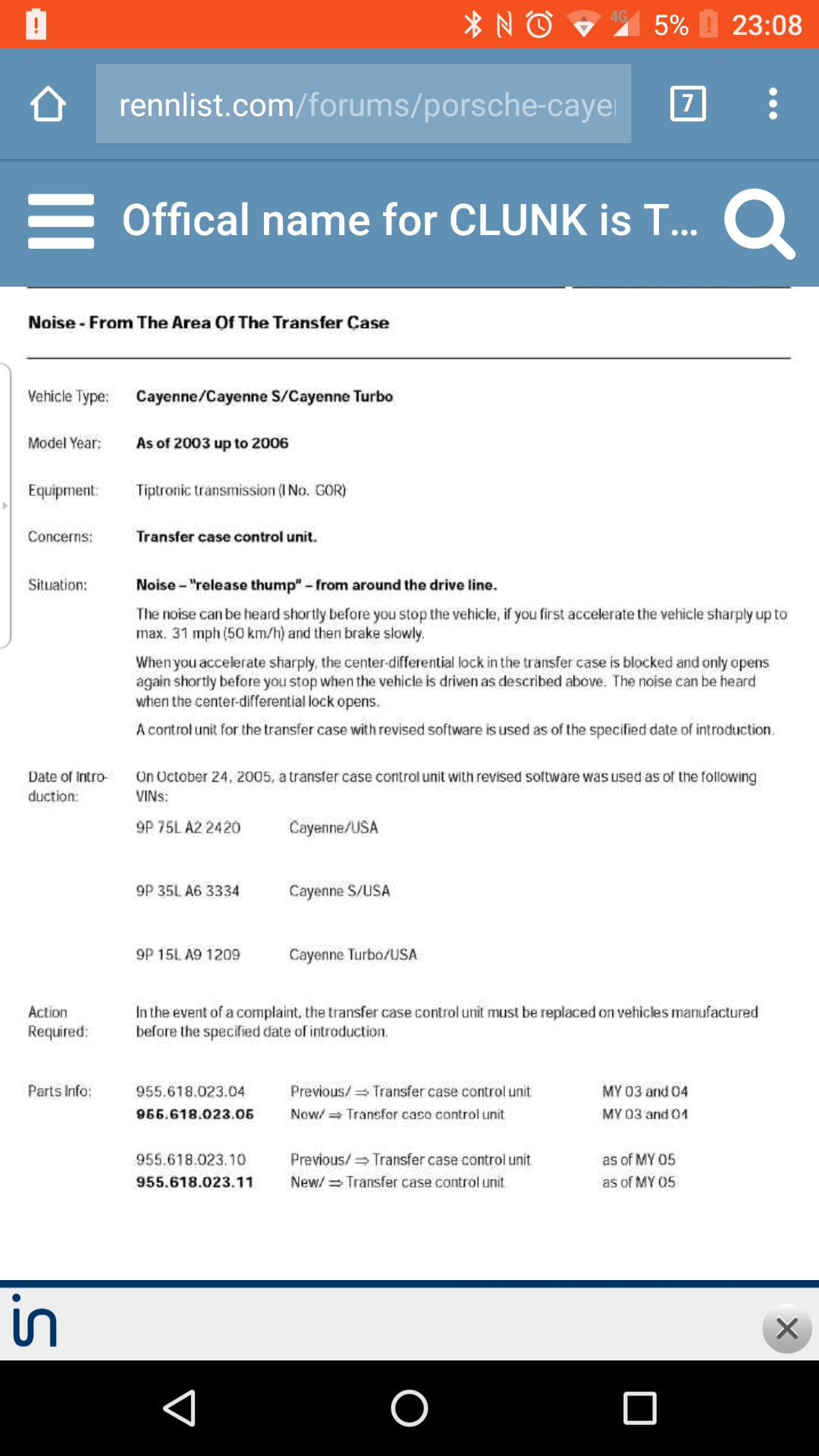

The clunk or "Release Thump" I have is mentioned in the tsb attached.
Could it be the jerks (stuttering) and thumps all are related to the transfer case and a update tcu module will fix all these problems? I can verify that I have the newer revision "C" stepper motor (older 03-04 maybe 05 cayenne need newer stepper motors apparently) so from my understanding only a newer revision control module is required to alleviate the issue. "Plug and play" in this instance apparently.
Can someone share their experiences of fixing this transfer case issue please.
