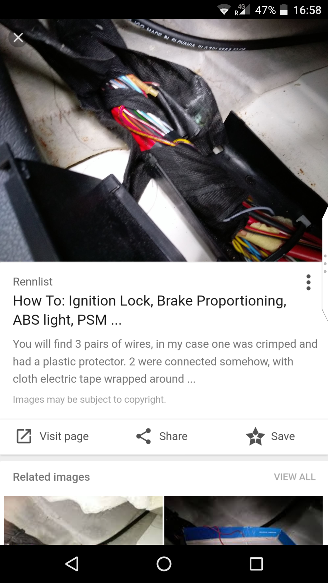

Your Psm problem is under your drivers side footwell and sidewell. I had this problem on my S. Replaced thousand of dollars in parts for a 5 dollar splice fix. Pull back the carpet and take off the plastic trim and start lightly tugging on some connections. My guess like mine the wires will pull in your hand. Cut/splice/fix repeat. I had e wires that did this.
Sent from my SM-G920V using Tapatalk
59 minutes ago, ekstroemtj said:
@ferraristyle thank you very much. I was thinking about this. Member Touareg pointet to the same direction.
what you mean with "plastic trim" ?
I'm sure he mean just this section which has plastic trim covering it
