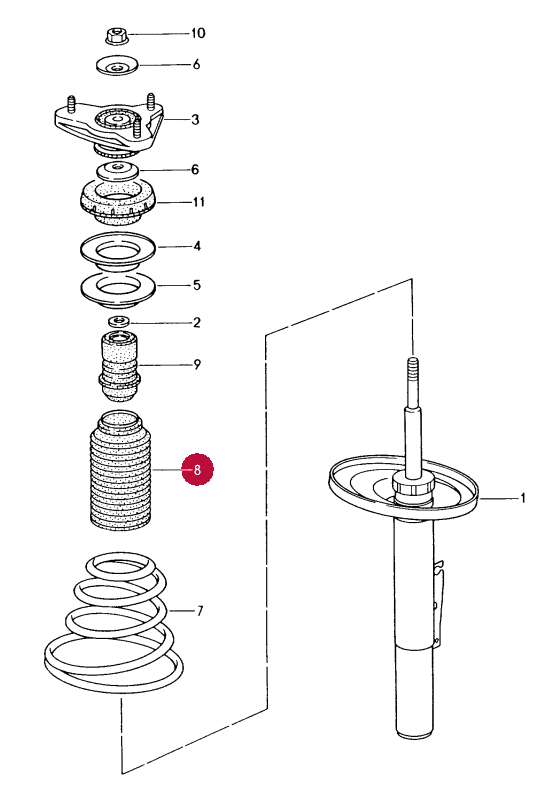

I've looked through the PET numerous time to no avail, If some one could point me to right page or part number it would be appreciated.

03 Targa  Front Struts , under cover, in between 3 bolts holding strut top hat

I looked at every page of PET, so it you could tell number and page that would be great.

No, it's a round plastic cover that you remove to get to 10 before you loosen assembly to drop out to remove strut.   It's under the hood covers that are to the left and right of battery cover.

someone gave me a old part #99970342940, the new part number is 99970345740 which I see isn't the same in that it has a slot in it. kind of defeats the purpose of sealing moisture.

Thanks for the help,, I learned a lesson on how to read the PET for un pictured items.

Yeah, many times small items are not pictured or numbered. You also can pay attention to quantity as that will tell you how many are used per car.
