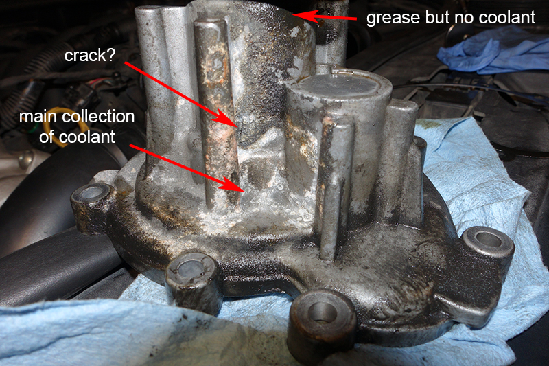

OK now this is strange - the pump is not leaking from the bearing at all, and it is tight with no play. But it is leaking badly out the pump body (now that I’ve relieved pressure on the system). Hard to see but arrow shows where it is coming out, about 2 big drips per second. It's dry under the bearing and pulley mount.

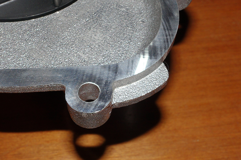

Looking at the new pump, it seems like it is coming from here:
What is this metal cap disc thing? Is it fixable? If my bearings are fine I’d much rather save the $400!

My parts came in early so starting tonight. Has anyone ever ordered an OEM Porsche pump? Mine looks kind of junky in my opinion. Is it normal to have scoring on the gasket face surface like this on a $400 pump? It doesn’t look like it was ground down and polished very well. Or is this to grip the gasket?

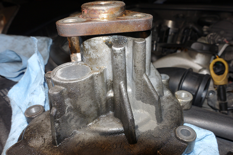

Yes, took a break for the night, but back at it now. Can't figure out what that steel looking insert is in the body of the pump. Haven't taken the pump itself off yet, but most things are cleared away.

OK, now I am really not sure it is the pump. This is the spray pattern...could it be a leaking gasket (blue arrow)? The gasket looks fine but there is faint pink on it that you wouldn't expect. Two of the bolts were not tight. Or a leaking tube or the upper rad hose (red)? The bolt has more spray on the bottom than on the top, so probably it is going up rather than down.
Pump looks fine on this side:
This side looks fine:
And on this side it is hard to tell:
Has anyone seen a pump looking like this before? Could it be spraying from the gasket, hitting the engine at that big patch in the first shot, and then splashing back on the pump?

Strange. First impression viewing your pics, not the pump itself. Spraying from somewhere else looks like.  No other way IMO to continue to check the water hoses arround or really maybe just the gasket. The pic with your arrows looks for me like the surface of the block where the pump is connected has a different colour.

Gasket leak Mike.
Maybe the loose bolts, maybe a bad surface fit.
Best to fit all new and torque correctly. Never need to worry about that part again.
New pump face looks normal.

Thanks Thomas and Lewis. I can’t see any other hoses there it could be spraying from, and that was not a crack on the pump, just a mark in the dirt. When I released the pressure to the system it started dripping from the bottom of the pump. If you look at the picture on the very top of this page it comes of the lower edge of the pump and collects on the flat part below it, then sprays due to fan wind I guess. This is a close up, pointing to a drip.
So I am thinking it must be a gasket leak too. If it was from that flat metal disk, that means the bearing chamber is filled with coolant, which would destroy the bearings, but they seem fine. I have always thought I smelt a bit of coolant with this engine, so maybe it has been leaking from the gasket slightly since I got it, and now it is worse. But could this really be just from one bolt loose?
