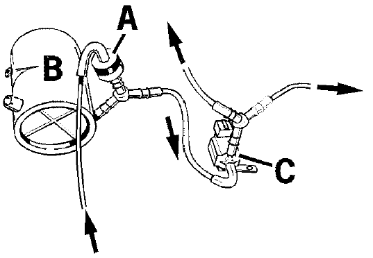

The PSE operates a solenoid that in turn operates mechanical valves via engine vacuum.
So, you may have a weak solenoid or a vacuum leak. Start by tracing back from the valves on each muffler (be careful they can get very hot).
  • Like 1
The vacuum in is off of the check valve (A). (C) is the solenoid and the two lines out go to the muffler valves.
(B) is a vacuum tank.
