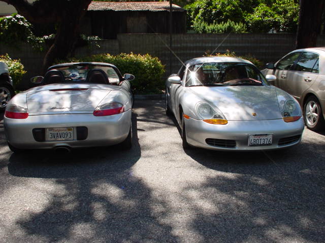

So, we met at my office.  I have a twin.  Something wrong with his changer or head unit as none of my magazines worked on his car, and his magazine worked in my changer.
