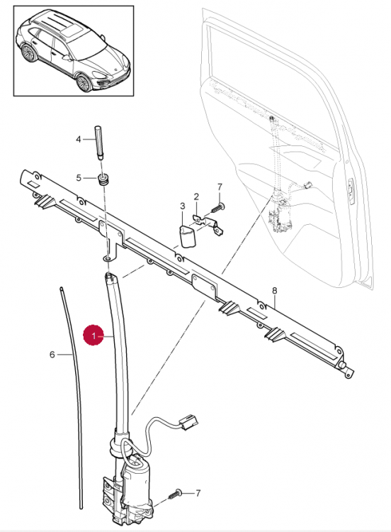

The drive mechanism is about MSRP $305 (for each side).

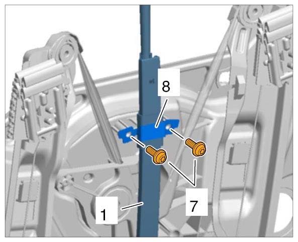

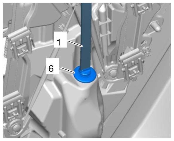

1. Unscrew fastening screws -5- .
2. Disengage connector on the control unit.
3. Unscrew fastening screws on the holder -7- and remove the holder -8- .
4. Press the sleeve -6- out at the feed-through point.
5. Guide the drive mechanism out in a downward direction and remove it.
Installation is the reverse just remember to position damping rubber -8- close to the bracket.
