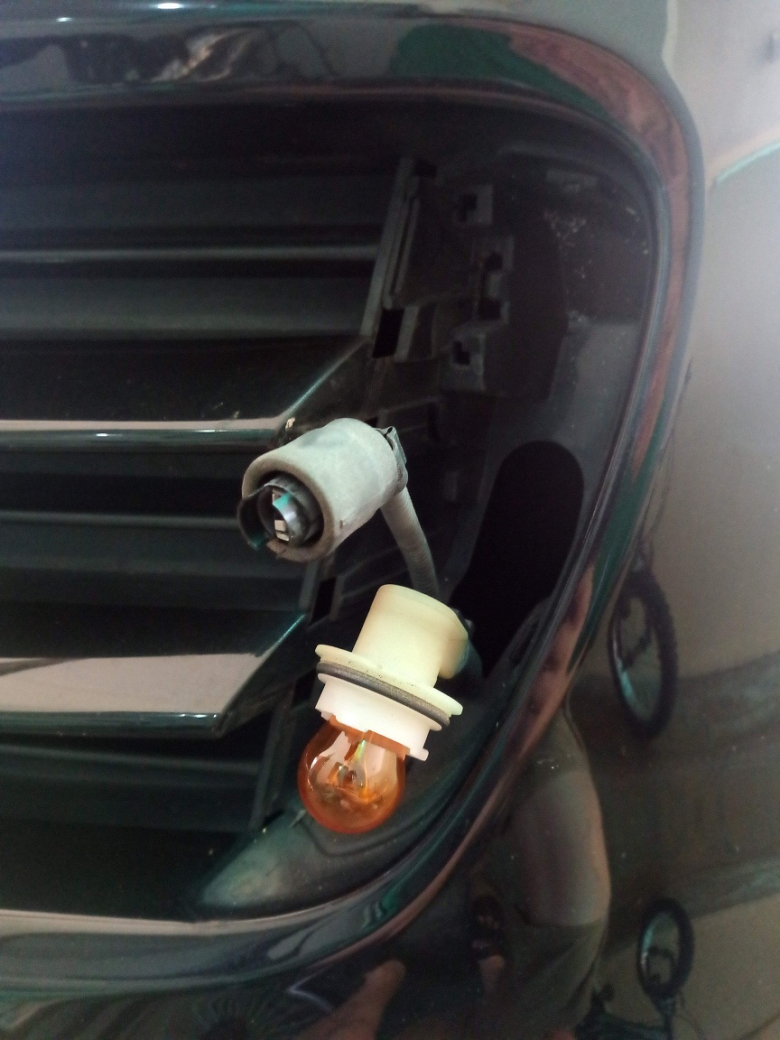

i have removed the T10 bulb in the "parking light".
Engine running for a few minutes, so far no error code in dash.
i plan to convert the T10 bulb to function either as DRL, or welcome light during unlocking car (or both, needs a bit more work on wiring and relay).
Edited by boonewe
Update:  i got error on dash "check front side light"
so, i fixed the parking light inside a half inch PVC socket (for domestic water piping ,without thread, grey color).
then, i put the parking light together with the PVC socket inside the bumper behind the parking light housing.
that eliminates the error on dash.
i didn't want to use the load resistor, because the load resistor can get very hot, it may cause damages also it is potentially dangerous to cause fire.
