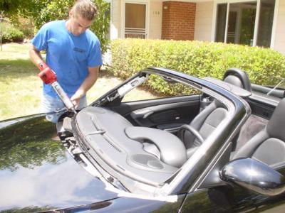

Bringing this back from the dead. I got a nasty crack in the windshield and just said goodbye to the Safelite guy (who is using an OEM piece of glass). He said he couldn't do it because a) he didn't have the trim for the windshield, and B) he said that the dash had to come out because of the antenna in the windshield. By the looks of the above picture, it wasn't necessary to pull any part of the dash.
Any educated thoughts on this question.
No need to touch dash. Call Safelight and have them send out someone that know what they are doing. Have them get the trim for you to.

Ironically, Safelite is the installer that is saying this. The trim is being ordered right now. We'll see what they come up with. They still insist that to get the antenna plugged they have to pull the cover closest to the windshield. I'm still skeptical. Anyone accessed the plug for the antenna without messing with the dash?
The antenna wire is behind the right A pillar trim. Depending on your options (diversity antenna) there may be another connector behind the left A pillar trim. Has nothing to do with dash trim. Never seen the plastic defroster trim removed for a windshield replacement.
I removed the A pillar trim myself because the visor screws go into brass threads and I did not want the shop to strip them.
However, the shop manual does say to remove the defroster trim - I guess so it can't possibly be scratched. Then you put it back.
This is the antenna booster and the connector in the A pillar trim that goes from the booster to the antenna wire in the windshield.
Thanks Tpants. I guess we (you and I) and them (safelite) are both right. I just am *very* hesitant to have them doing anything that might lead to rattles in the dash.
Lane, fortunately, this is covered entirely by insurance in my state. Frankly, considering the pitting that I had / have in my current windshield it is going to be nice to have a smooth surface again.
