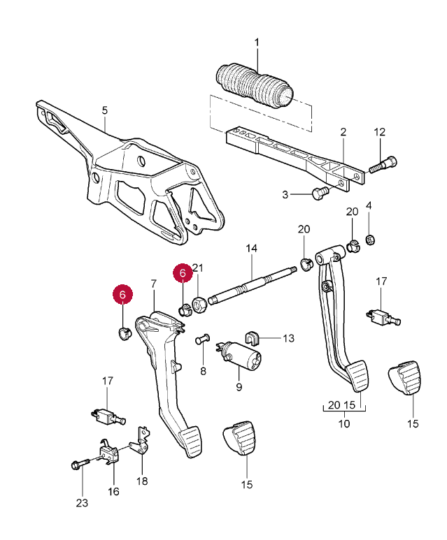

Sometimes there can be a binding in the pedal mechanism - check for debris, clean and lightly lubricate the bushings.
Also, check the clutch power spring (item 9) for binding or wear.

Thanks.  Took a look at your suggested action.  After hearing sound again, it definitely feels like it is coming from master cylinder area (vs in pedal housing or slave).
Safe bet to start with replacing that?  Just haven't heard anyone say they hear a click with this part...usually a squeak or squeal...right?
