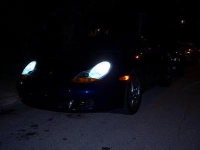

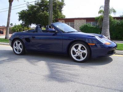

Hi Guys,
New to the forum. Just installed an HID conversion kit. What to you think?
In one picture they look kind of too blue but, I think its just the reflection or
something. :huh:
Looks good.  What kit did you use?
I bought it off ebay. JDM 8000k kit for about $280.
Beats the heak out of those yellow bulbs it had!
Took me about one hour to install taking my time to make sure
i did everything right.
Thanks

Brightness is alot better than stock and 10 times better than the fake bulbs. I once tried those bulbs and you cant even compare to these hid conversion kit. Im sure that the litronics original kits are better but these aren't too far behind.
Sorry, but this looks like a waste of money to me. Not really your fault, as these companies should not be allowed to sell such products.
The reflectors in the halogen headlights are not designed to accomodate the HID light bulb. The end result is an overbright light, with a ton of glare and unfocused beam. You will be blinding oncoming cars with an extreme amount of glare because the light is unfocused.
Read on below, the NHTSA has ruled that these kits are illegal as the beam blinds oncoming drivers and is unsafe.

Nah, Not really a waste of money. Atleast it improved my lighting and visability. Plus im not blinding other drivers as I live in Miami and get a :censored: load of traffic daily. Im sure im bound to run into someone who will flash at me to turn off my lights but, not one yet. I've also driven with other people who have been in front of me and everything is ok. No blinding. Conclusion.....dont believe everything you read unless you have tried it yourself. I dont mean to be rude either.
There are a lot of ricers around where I live with these illegal retrofits. They are absolutely obnoxious at best. It's a misnomer to say they are conversions because they do not convert the optics/reflectors. Maybe you can get away with it (partially) if you aim your headlights at the ground, but as noted, the halogen reflectors/optics are not designed for HID bulbs. If 100W bulbs are illegal for street use, then HIDs are equivalent to approx 150W bulbs and, worse, they are aimed/focused wrong.
