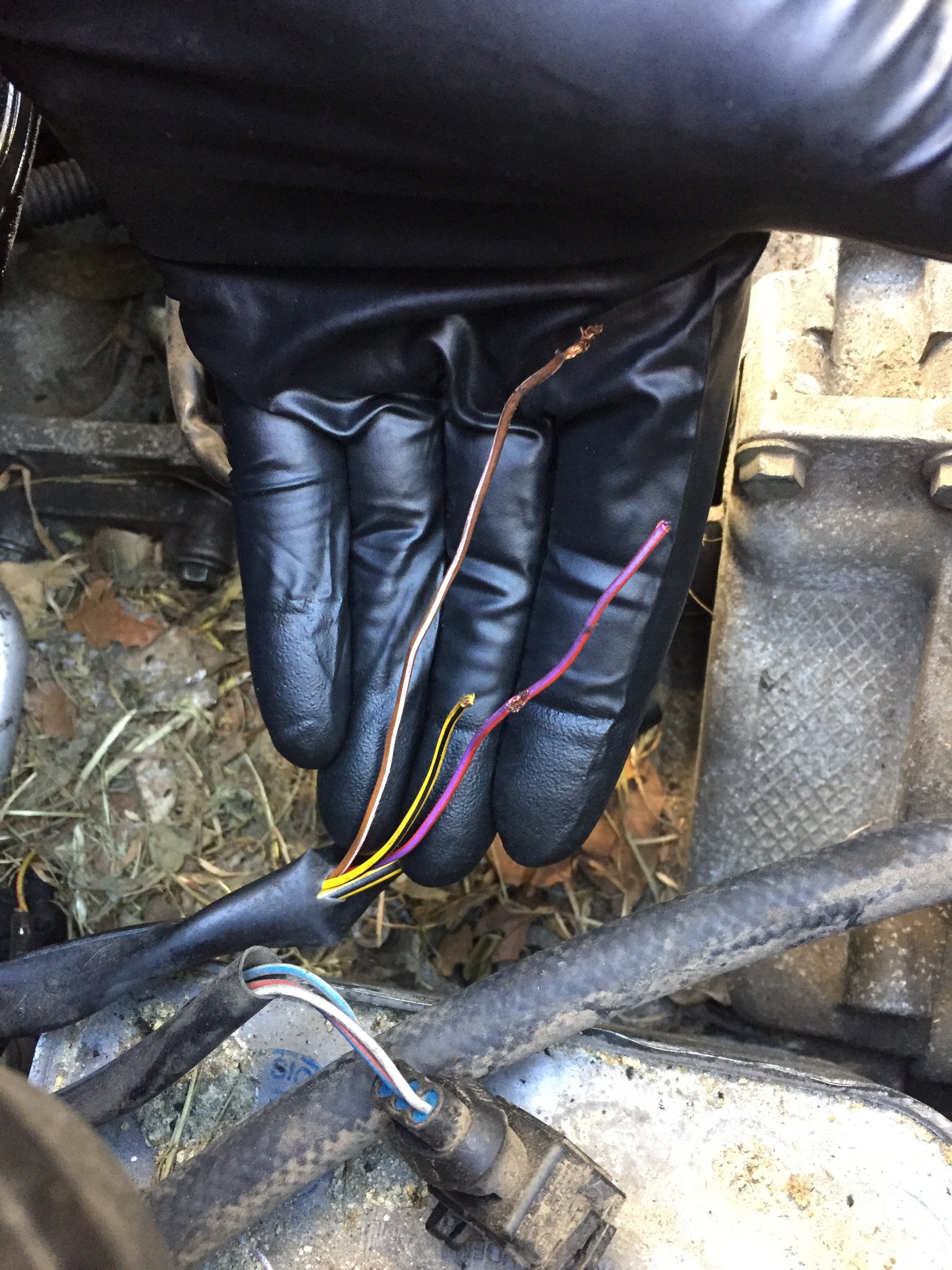

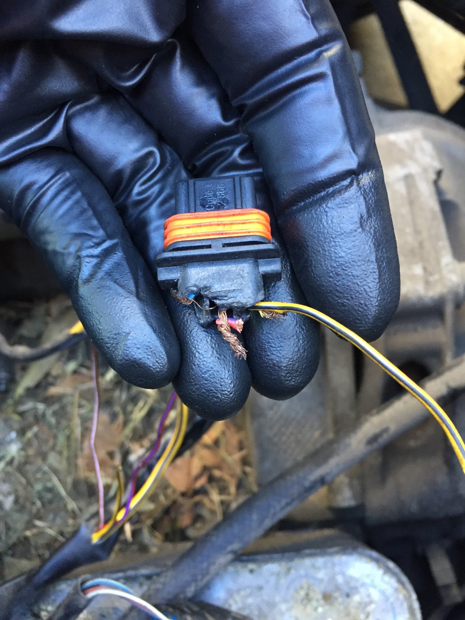

Looks like on my project Boxster, a CEL (code P0123) is caused by a rodent chewing through some wires.  The project car is a ‘97 Manual.
Does anyone have a part number for the connector that plugs into the TPS, or know where I can find one to splice in?  The Bosch part # for the TPS is 0280122016

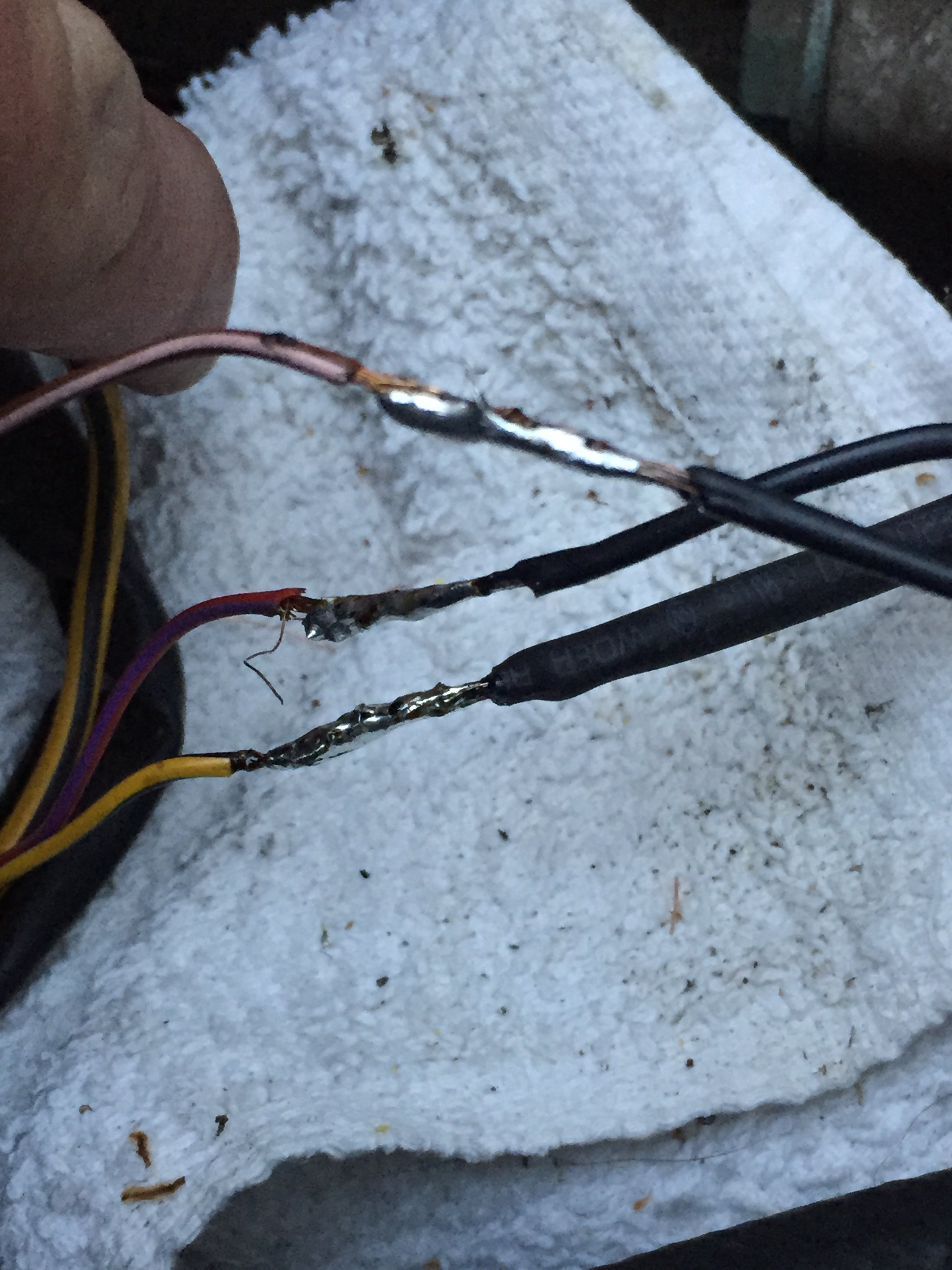

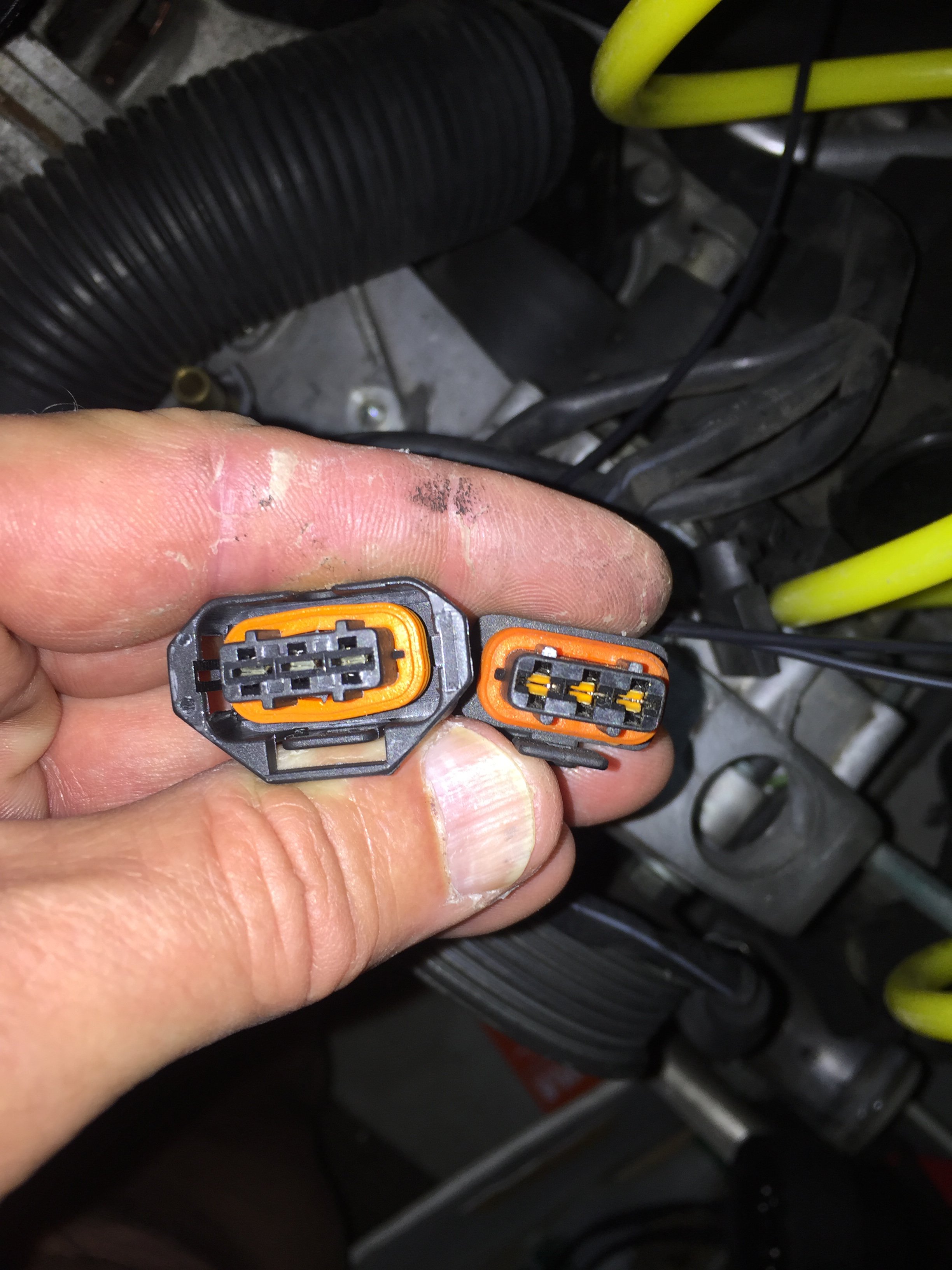

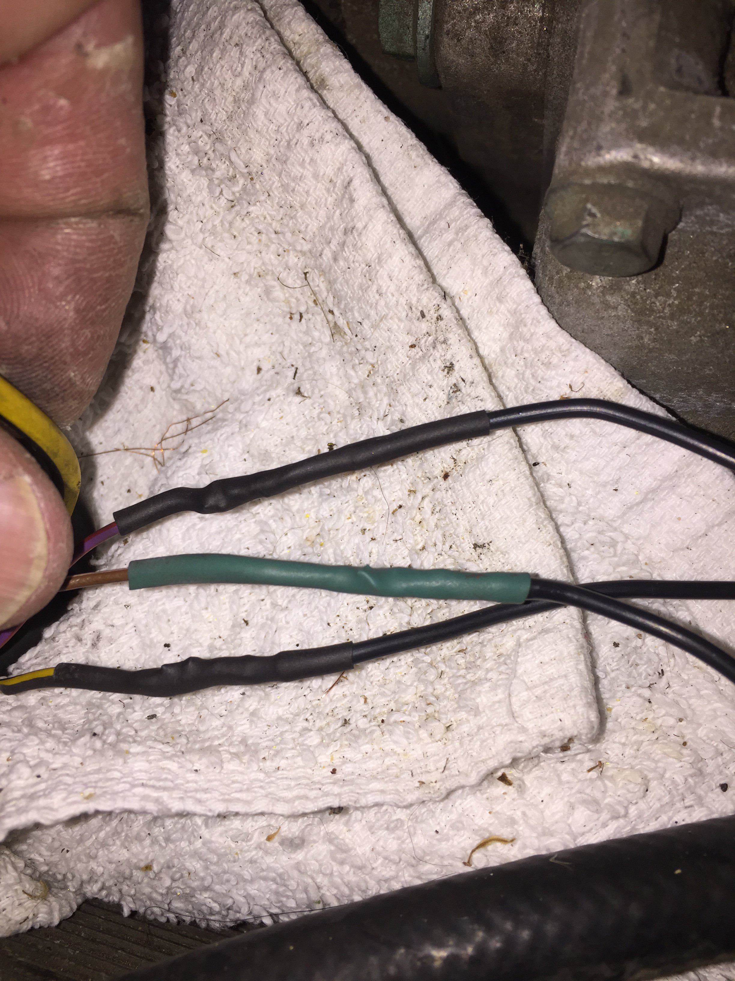

In an attempt to find a “plug and play” solution, I found what looks to be an EXACT match for the TPS and connector. I ordered one and it came in today. Both the TPS and connector was about $11.
I figured worst case scenario, I would replace the TPS and then becassured of a connector that fit.
The outside look a little different.

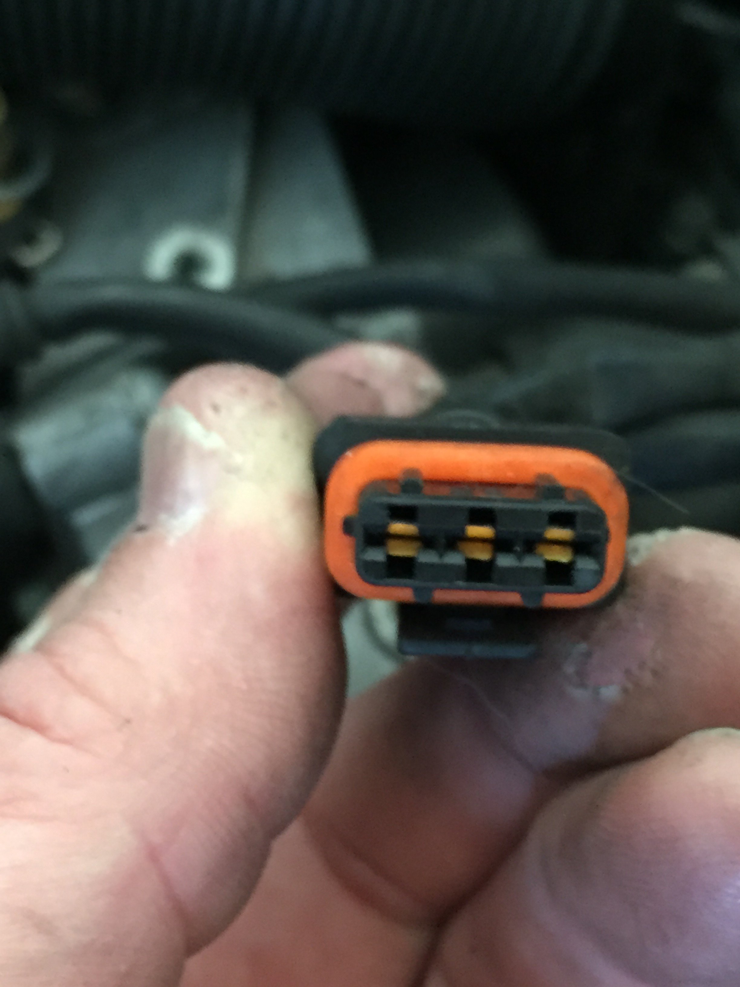

End view of connectors looks to be exact match
And the two TPS sockets look exactly alike.
Even the part that connects to the Throttle Body looks the same.
