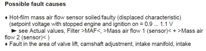

So the scanner was from the repair shop I used, Report I have says Autologic Diagnostics.
P1081: Air mass ahead of throttle valve, partial load.
P1094 Air mass ahead of throttle valve, implausible.
So it does seem like your readout from the 1094 answer may also fix the 1081
