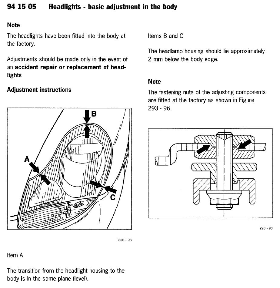

I've only been able to find a couple post about adjusting the mounting bracket with nothing more than an engineering drawing of the adjustment screws.  But how does one go about getting to the bottom of the adjustment screws?  Looks like to me that there are two ways.
