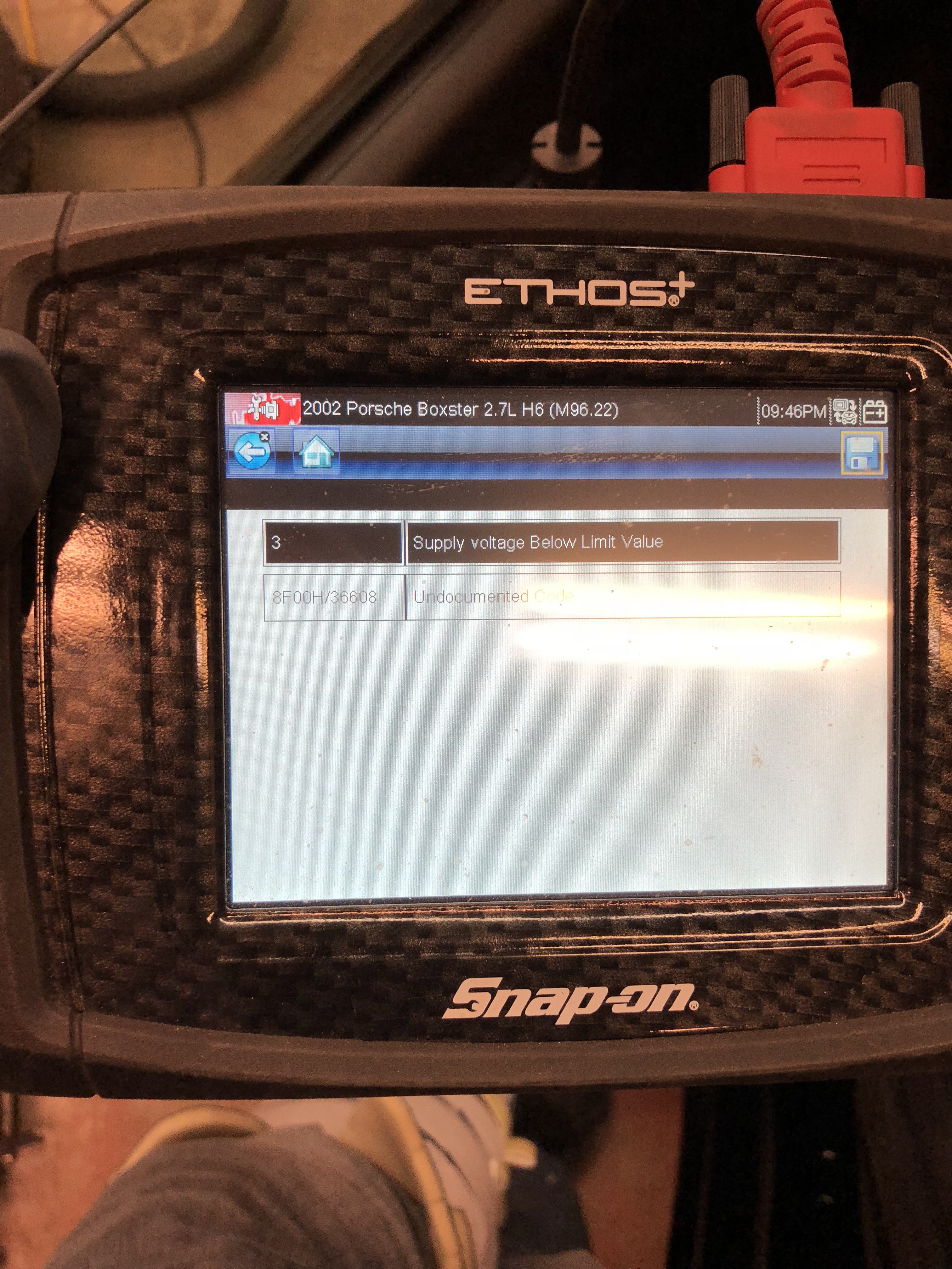

Hey guys, I've been chasing this airbag light for a while now. Replaced seat belt buckle with a new one, replaced passenger door airbag with one from ebay. Below are the codes from a snap-on scanner, granted its not a PIWIS tester but it gave me something. Had a more advanced scanner saying passenger door airbag which is why I went that direction. Any help is much appreciated thank you!
Try Durametric or PIWIS.
Porsche Boxster airbag codes for your model year car go from 1 to 88. And, anything that is 100 or higher is a bad airbag triggering unit.
When I have seen a (rare) airbag triggering unit failure is was always accompanied by additional individual airbag fault codes.
That's why I say try a different tester.
Also are you sure you got the correct airbag for your car - they changed (due to law changes) in MY2002. So if you have an airbag from an earlier car it won't likely work.
