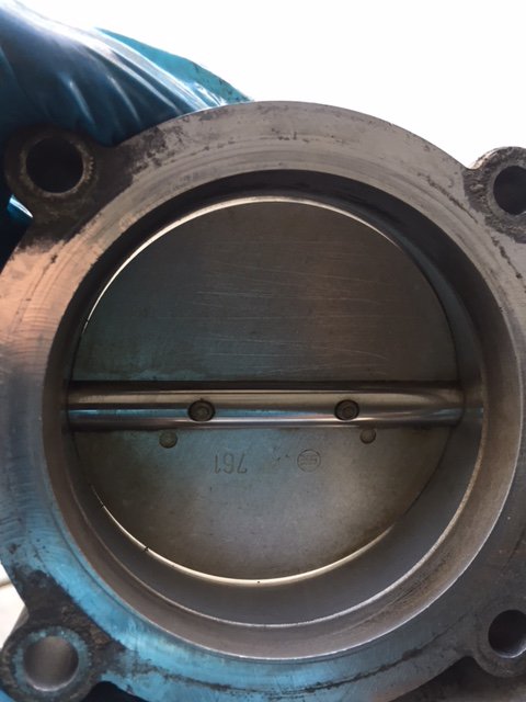

Should throttle body at rest be slightly open?
I just removed and cleaned my throttle body as a step in trying to get a nice stable idle, and I noticed that at rest, the plate is slightly open. Here are a few pictures to illustrate it - is that a normal state?
After cleaning it, and it was moderately soiled, I also attempted to reset the adaptations via Durametric. Following the instructions, it says that once completed, the final value will read 14 - mine started at 11, and after following the process - ended right back at 11. Not sure if that is related so I thought it best to note that too. No other significant errors present.
