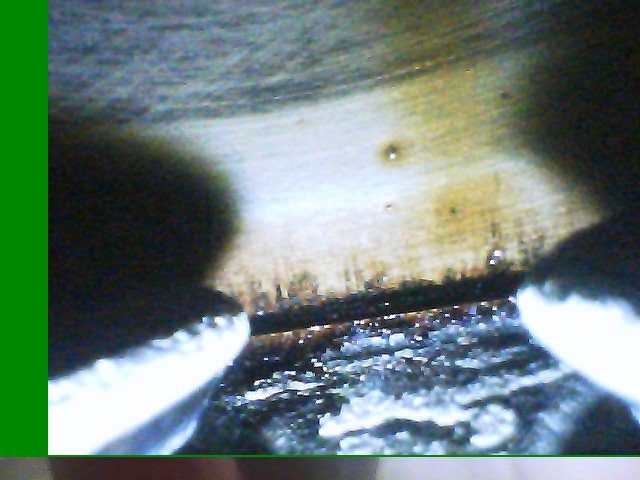

I've just had a C4S borescoped as part of pre purchase inspection
The car had cylinders 4,5,6 re lined a few years ago with addition of a new piston however, it looks like Cylinder 4 has a pool of oil and 5,6 have oil starting to appear. Cyl 1,2,3 all look normal
What could of caused this after only about 15k miles worth of driving and what is the potential solution?

Oil in the cylinders can come from several sources, the bigger question here is are you ready to buy a car that you may have to pull the engine out of for some potentially serious work, or would your time be better spent looking for another car?  If this were in my shop, I would tell the potential buyer to look elsewhere unless they are getting the car really cheap and are ready to take on a possible major engine overhaul.
