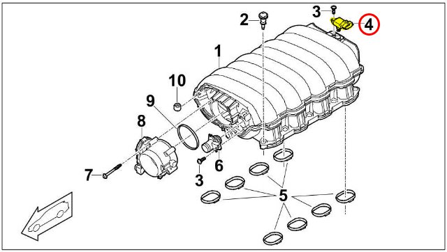

On 9/18/2018 at 3:07 AM, Dopeyskydiver said:
Are you referring to the Manifold Pressure/Vacuum Sensor? If so, it is located on the top rear section of the intake manifold.
2143660626_ManifoldPressureVacuumSensorLocation.jpg.ac278c538966b129ecf67773d6dd19e2.jpg
yup i think that's it,thanks you very much.

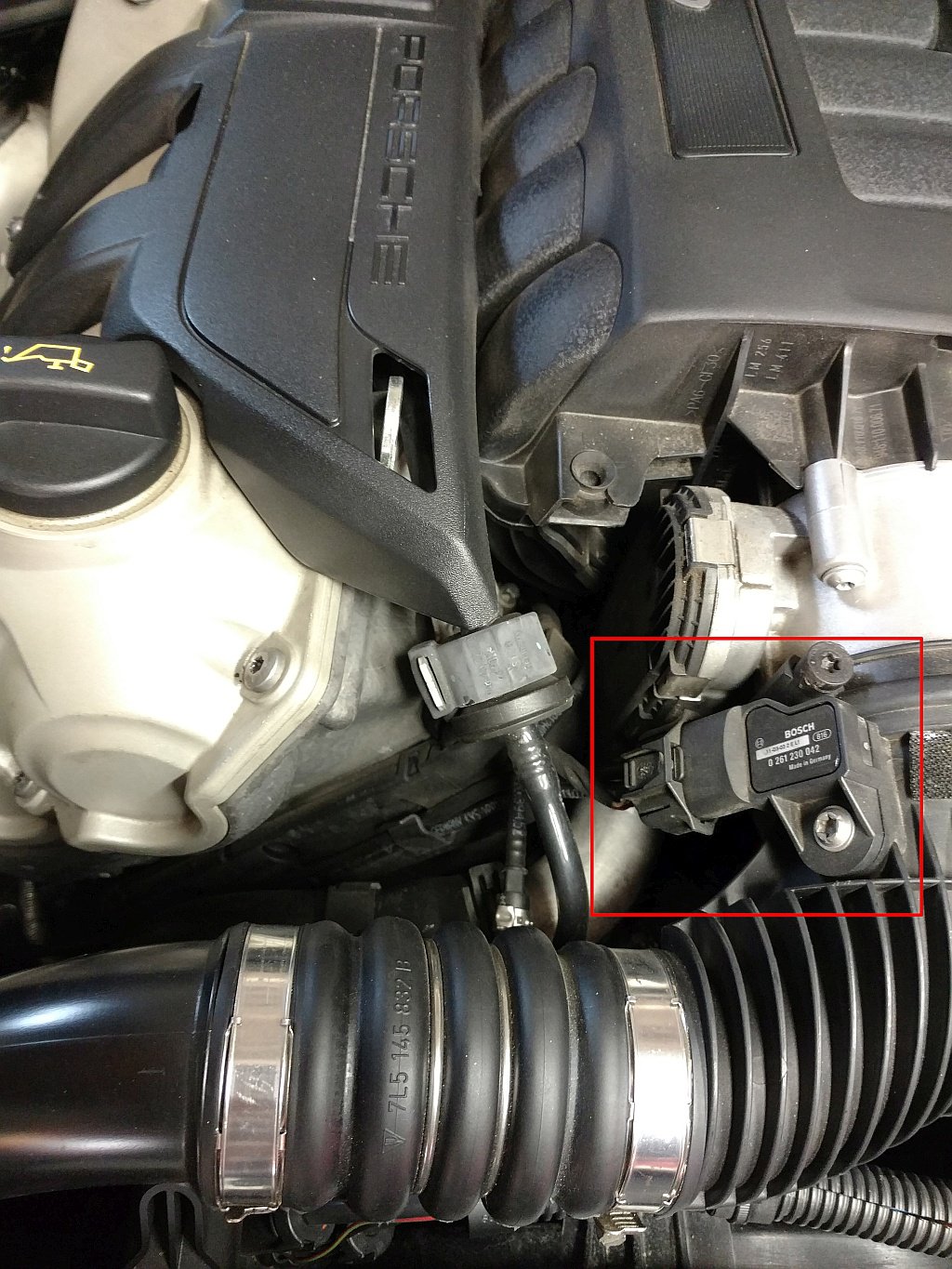

That depends on the year/model.
Just a FWIW - if it's a turbo (your S obviously isn't) - that's not it.

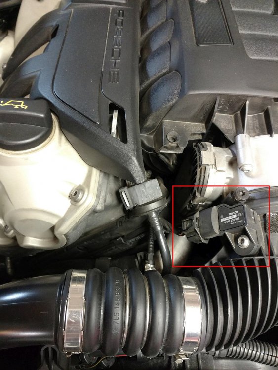

On the 958 turbo V8 - it's located ahead of the intake throttle body in the Y tube leading to the intake.  It's the device in the red box in the attached photo. It's lots of $$$ from Porsche, but if you search on the Bosch PN - you'll find it was used for everything from Chevy turbo engines to Rolls Royce turbo engines.. and the price can be as little as $18 with just a bit of searching (and your nearby NAPA store if you're in the US probably has one in stock.)  If you're going to replace the one in the parts diagram - might be worth Googling the Bosch PN that is likely on it. It might be much cheaper than you might think.
Turbo MAP (Manifold Air Pressure sensor):
