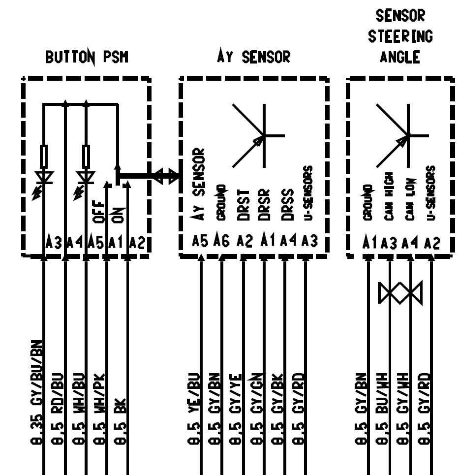

My question is, does anybody know which of the 5 pins on the back of the switch are used for the lights? Though the switch is not used anymore, when I turn on my headlights the switch does not light up anymore and I'm just going to directly wire to one of the other switches. But to do so I need to know which one of the two, or more, poles that it is to use.
