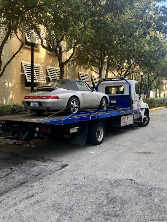

I decided to send the car to my mechanic to fix the ball & Socket issue as I live in a condo I don't have garage space to do the repairs.
Thank goodness for AAA as is no cost to send the car to the mechanic via flatbed.
