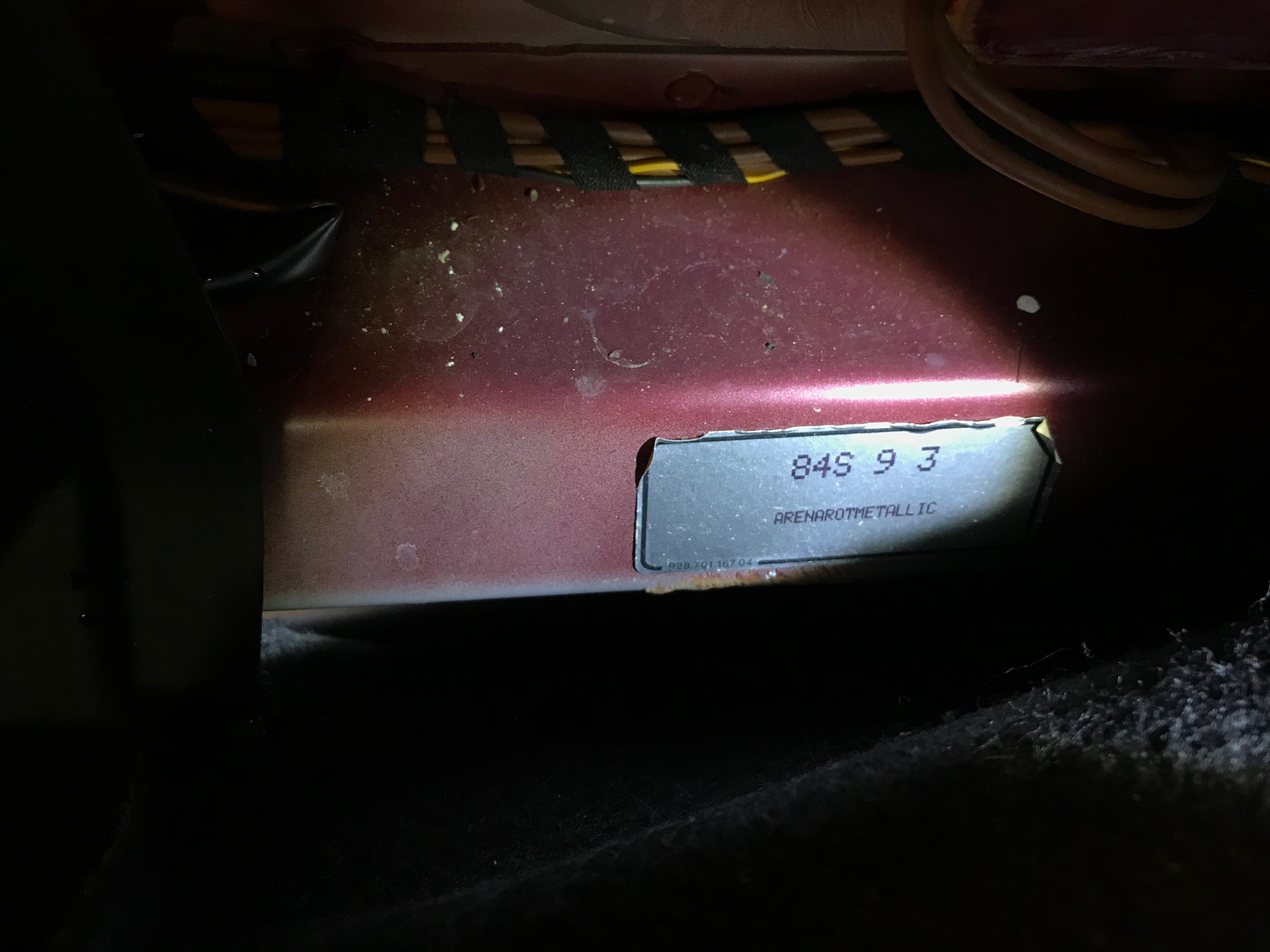

Thanks for the compliment on the color. I'm actually a fan of it as well. At first, it kinda struck me as an awkward/unfortunate maroon/dark red thing, but it's really grown on me.
I'm by no means any sort of purist, or one to be anal over the details, but it's apparently been named "Arena Rot Metallic" which I've read translates to Arena Red.
