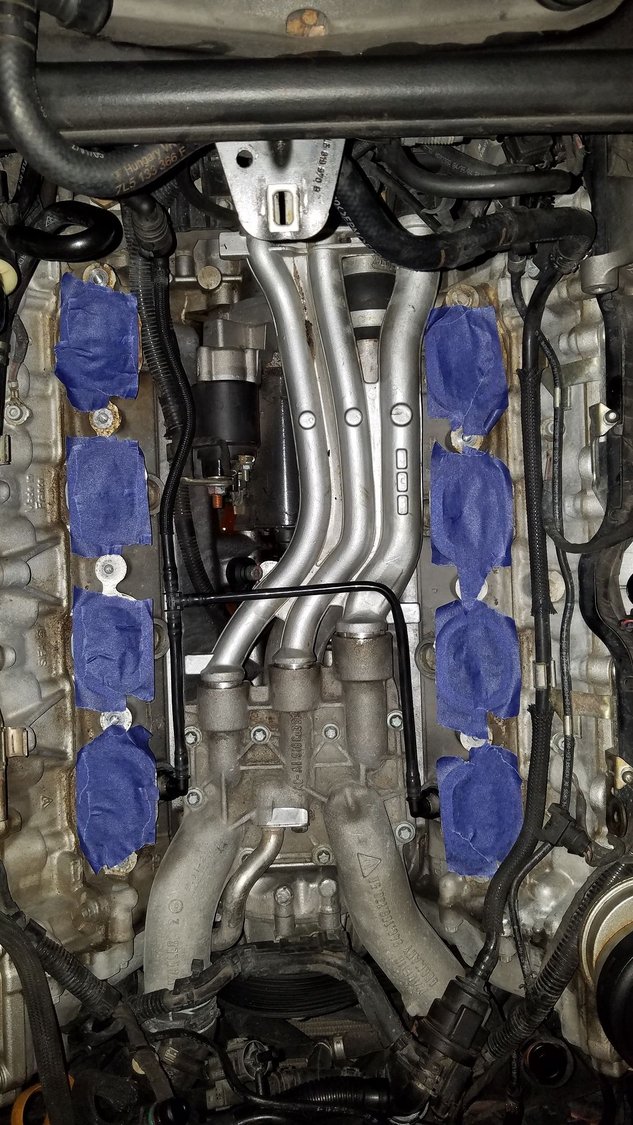

Took the intake out, looking in and observed some coolant near/under the starter area (under left or pass. bank of cylinders), under the pipes near the thermostat area, also see some coolant under the right bank of cylinders, inside the V of engine.
Did not really see much wetness near back where the T connectors are.
Planning to do a pressure test when my tool comes in (hoping tomorrow).
Looking for folks to look over the pics/vid, and tell me if they see suspect info that can make PD easier or direct to an area.

When my coolant Ts blew up (the two to the back right of the engine against the firewall) yes there was coolant sprayed everywhere, and some made it into the V of the engine. There's also that bleeder hose which is prone to becoming brittle and cracking which would dump coolant there, although yours looks ok.
Are you talking about the long thin, black hose looking like a number 4, going from rear of engine bay, to front of it, connecting to each side of the intake?  That one was replaced by the repair shop about 2 years ago.  Contemplated replacement, but touching it, does not appear brittle at all.
Now, I am looking for a place where I can order all the o rings and rubber pieces for the coolant pipes, plus gasket for thermostat housing.  Dont need pipes, just the seals/gaskets.

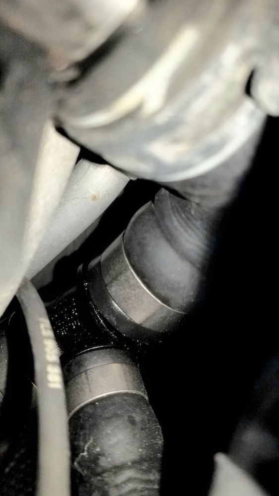

...so, have intake off, pressurized system, found leak. Large T. Still puzzled why some coolant was in valley of engine. Could the large T breach and spray some into it?
Aluminum Ts and OEM hoses already on way.  Thinking of replacing O rings on pipes just in case but few folks told me they will be fine if recent (which they are).  So split on that decision.  Was also thinking reseat thermostat pan, but it looked dry there and feeling under the coolant pipes going to thermostat I did not feel any moisture on fingers, and did not see any moisture on pipes with a plumber snake camera.

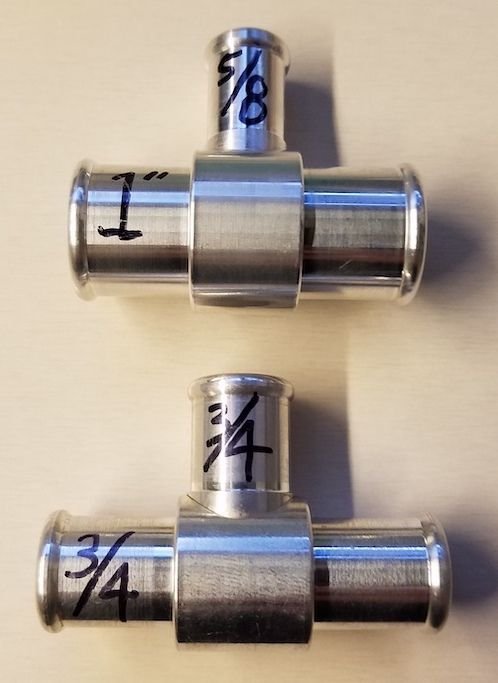

Here are my new replacement Ts, from JagsThatRun.com. They charged me $24 per each T, shipping $10 to country of Texas, total $58 delivered within about 4 days total. So turn around was super quick and I am super happy.
Also ordered OEM hoses that include the plastic Ts. Will remove hoses from those Ts, and install on the metal ones for installation onto the car. Then will do the pressure test again to make sure no other leaks are there, and then onto putting all back together.
Ordered from here in case you have same issue.

As an update, the large T (part of a water hose assembly), made of plastic, cracked right at the T junction, underneath the part of hose slid over the plastic and clamped.
There are two Ts on Cayenne Turbos, large and a small one. They are both made of hard plastic. This means, after 40 or 50k miles of replacement with new parts, you will be back in there, replacing yet again.
To remedy this, I ordered two aluminum Ts, meaning I will never have to worry about the Ts leaking again.
Adding to the crack, I also noticed that the large coolant pipe water hose (short and large rubber hose connecting the large coolant pipe with 2 clamps), was leaking at bottom as well. This was discovered after i replaced the Ts, and did a pressure test on coolant. The problem revealed itself right away.

- Aluminum T (large) - 1" x 3/4" x 1" - Order Here
- Aluminum T (large) - 3/4" x 3/4" x 3/4" - Order Here
