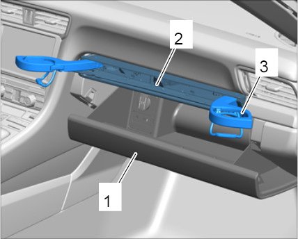

1. Open the glove compartment 1.
1.1. Open the cupholder flap 2 .
1.2. Pull out drinks slots 3.

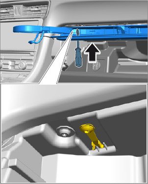

2. Release cupholder.
2.1. Release fastening clamp on the left and right arrow.

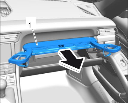

3. Remove cupholder.
3.1. Pull cupholder 1 out of the guide towards the passenger compartment arrow.
Installation is performed in reverse order to removal.
