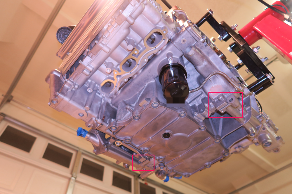

Going by memory, the engine is ~350lb and the transmission ~130lb so most of the weight is on the engine. You want to support at least the two main reinforced parts on the engine case (shown in the photo). Also try to support the transmission (right below the axle flanges) if possible.

Thanks Ahsai, useful data.
Having an idea of the weights will help in this calculations.
