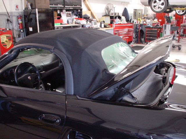

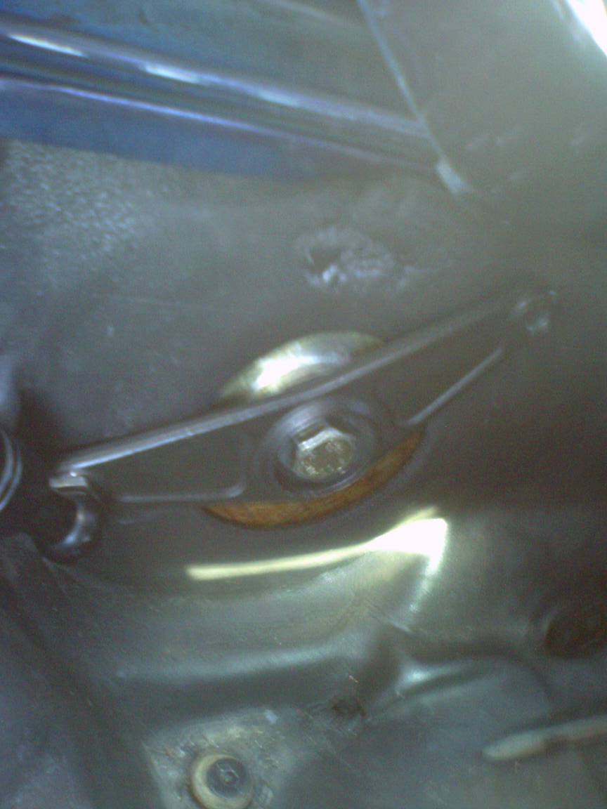

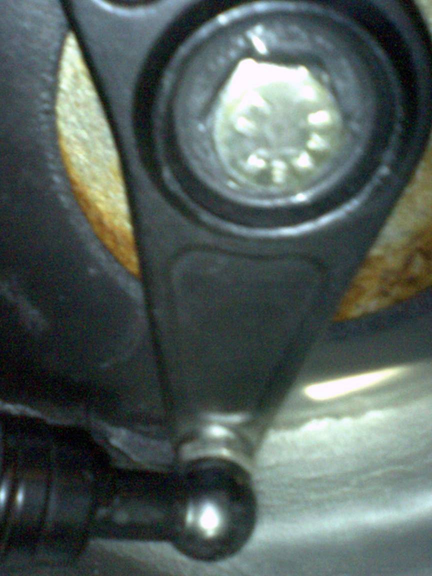

Mark is the timing expert so I hope he sees your message. I recently tried to time my transmissions and the clamshell locked down in the down position and would not move when I pressed either side of the switch. So I was off on the timing. I contacted Mark for help but he moved a little bit out of the area so I went to my dealer and took the following 3 pictures so that I would know the position of the V levers in case I would give it a second try before I could get together with Mark. I have not had the "time" to try a second "time." :P
I have never seen a top run in reverse, so this is a guess.
The V lever has a male ball joint screwed into one end of the lever for the push rod that operates the clamshell. The other end of the V lever has a bolt for the push rod with the plastic end for the roof. So there are 2 push rods attached to the V lever. Do you have these push rods reversed? Or, was your V levers bolted to the transmissions so that they are 180 degrees off?
These are the 3 pictures I took at my dealer of a Boxster if I was going to give a second shot by myself. You can see the position of the roof, the clamshell, and that the V levers are pointing down. From what you said your roof is in about the same position in my pic but your pic shows the V lever facing up.
My guess is that you are 180 degrees off with something. Either the V levers were bolted on so that they are 180 degrees off. Or the the push rods were put on the wrong ends of the V lever which would also make you 180 degrees off. Or you have both situations. At least this is my best guess.
