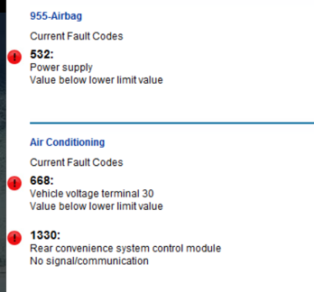

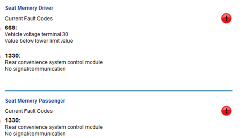

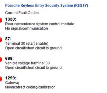

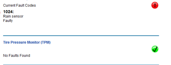

Using the Durametric Diagnostic Version 6.5.5.9 I get many Fault Codes. In particular, ones relating to the  Vehicle Electrical System;  Fault Codes: 185-Relay to Terminal 15 (activation) Open circuit/short circuit to ground;  576-Terminal 15; Code1330-Rear Convenience System Control Module; Code 1517-Trailer Hitch Control Module(AHK); Code 907-Load Management Operation on Vehicle Electrical System.
