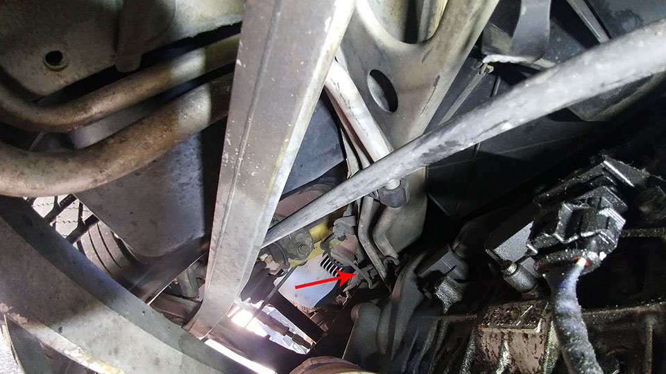

I poured about a pint of distilled water into the coolant tank in the trunk (which is yellowed and should probably be replaced whenever I find what is wrong) and noticed water dripping from the open end of a hose (see attached photo). I'm not sure what this hose goes to or if it's supposed to be open.

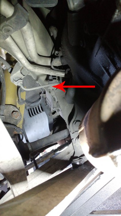

Hard to tell where the arrow is going but it sounds like you probably dumped from the coolant reservoir overflow hose, possibly due to an overheat or over pressure in the reservoir.  I would first refill with distilled water to see if it will hold without leaking. You might have a bit of residue from the previous dump. Make sure it is filled properly and burp as much air out as possible without overfilling. Common culprit is the cap. Make sure you have the latest revision and/or that yours is functioning properly. I would start there. If you confirm you don’t have latest revision then replace it, refill with distilled water first to confirm it solved your problem and then properly refill with coolant.
Ok, thank you for the insight. I do have the updated cap because a couple years ago it was leaking out of the top of the old one. This one seems solid.

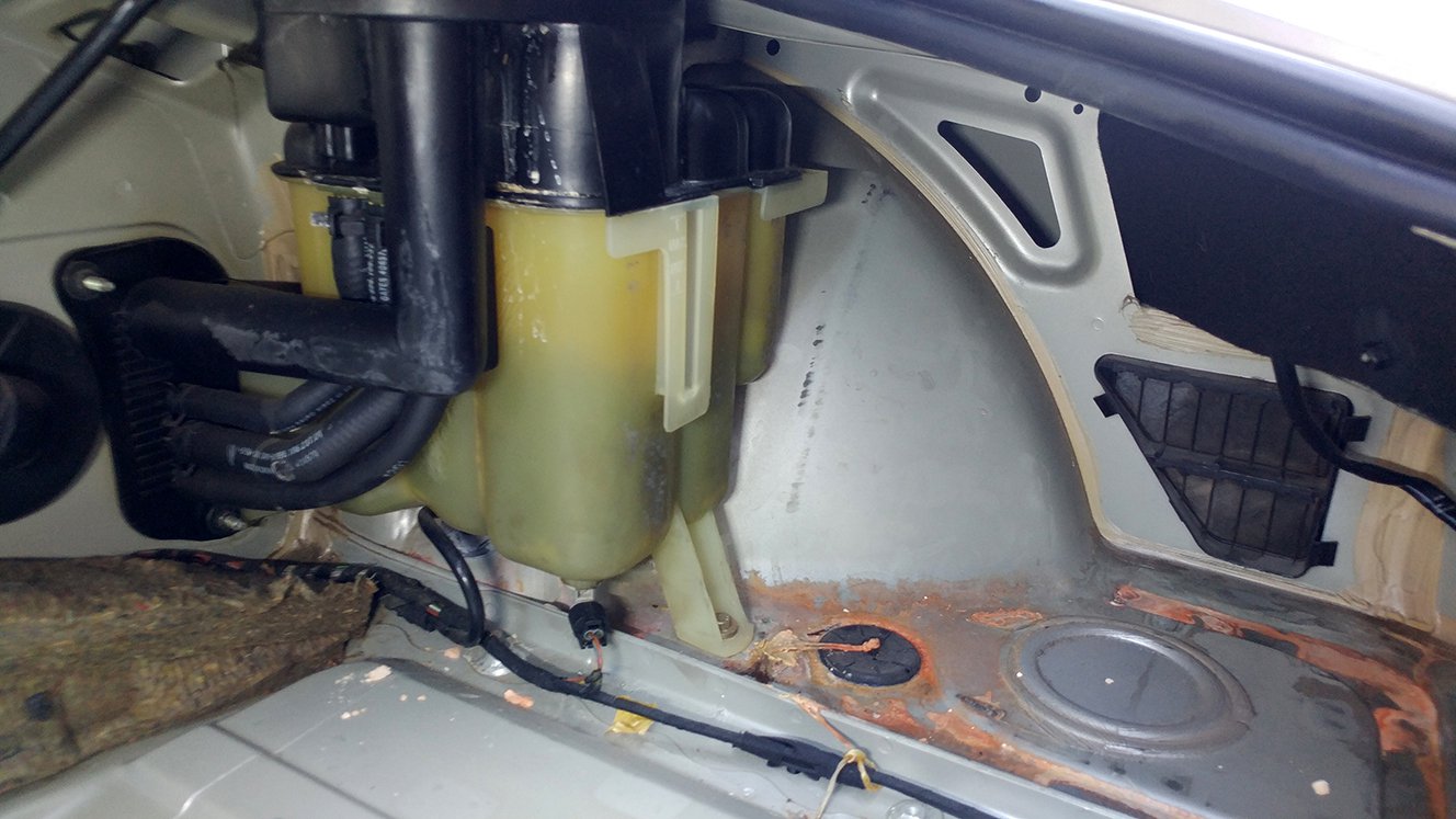

I did fill the reservoir with distilled water today and a little bit dripped out of that hose (if there is a reservoir overflow hose, that's a safe bet for what that hose is I guess) but it seemed to be staying level after that. I attached a couple photos of the reservoir tank. In these photos, it is empty, even though that faded mark makes it look like there is coolant in there. I also attached a different photo showing that open hose (that may be the overflow hose)
If the reservoir has never been replaced then I'd recommend it.  You have clearly had some kind of leak in there given the red crud all over the trunk.  Many 986 owners suggest changing the water pump every 30k miles as preventative maintenance, which I subscribe to personally as well.  It is relatively cheap and an easy job.  While in there, I would put in a low-temp thermostat.  Same price as the standard one and your car should run cooler.  Unrelated to this area specifically, but related to the overall cooling of the car, a good cleaning of the front radiators has always been very effective for me personally.  It is amazing what gets stuck in there over a couple of years of driving.  If yours have never been cleaned at 130k mi, then you will be shocked by the content.
