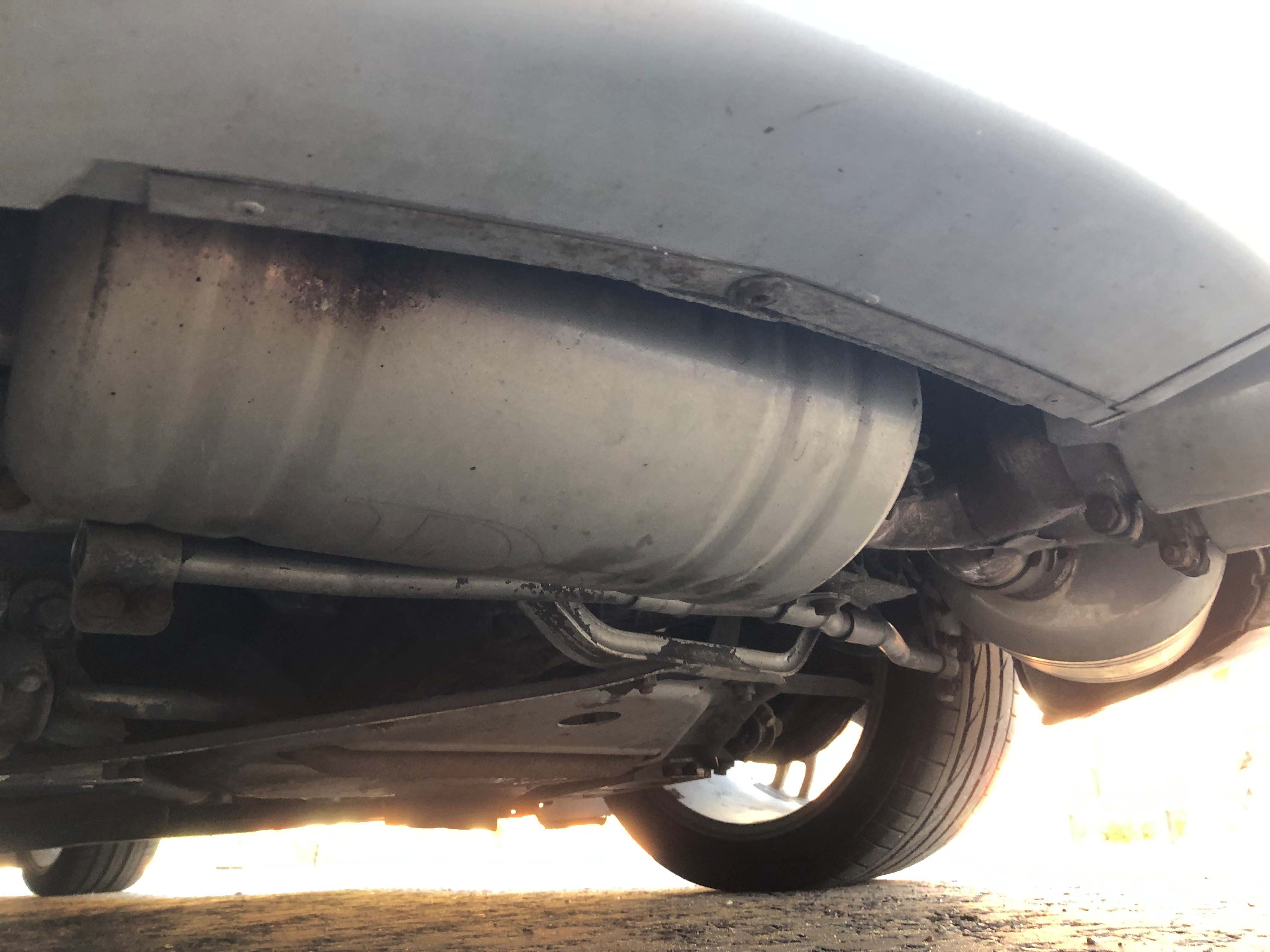

2. Exhaust. This thing is LOUD. It sounds really nice after 3K RPM but in higher gear/low rev (cruising) it resonates through the cockpit and gives me a headache. It was fitted by a Porsche Specialist, was told it was a PSE, but there is no exhaust/sports/PSE button in the car. I reckon they have clamped the valves open all the time, and I do not want this. Preferably I want to control the valves with a switch, but if this is really expensive then just having the exhaust operate 'normally' is fine to open after a certain RPM. Driving it back in 6th it was a huge headache, any slight touch on the gas vibrates and makes a really deep sound which isn't particularly pleasant. I'd also like it to be more discreet in low revs/low gears. What can I do here?

No true factory PSE drones, period.  If a PSE is installed without all the controls, the default position is open or loud.  Takes some pictures and post them, I'm willing to bet it is a cheap aftermarket unit.

I've attached a picture best I can of the exhaust, hopefully you can tell me what it is and if it's sh*t! Now i've viewed them, there is some sort of branding with a big "D". If you still can't identify then I will try to get a better shot from directly beneath to try and see the full brand name.
Yeah he didn't say it was a factory part (i asked if it was OEM, he said no) but said it was a Porsche exhaust. Just trying to find out what it is so I can call up and ask some garages what they can do with it. Is there any way to change the existing exhaust I have to a switch? I just don't want it loud all the time, especially as I want to drive it on the motorway sometimes - perhaps taking it abroad for some touring, and the drone reverberates around the cabin quite a lot with the hood up. Any slight touch on the accelerator has a really deep, loud sound which i'm guessing vibrates the soft top. Perhaps I can dampen it out in the cabin with something against the cloth?

It would be a bit of a nightmare to convert a non switchable exhaust to a switchable version.  The factory has bypass pipes welded inside the muffler to facilitate the two pathways, the system you have does not, so they would have to cut it apart and weld them in.  I think that would end up costing you more than just buying the real thing and selling the unit you have.
