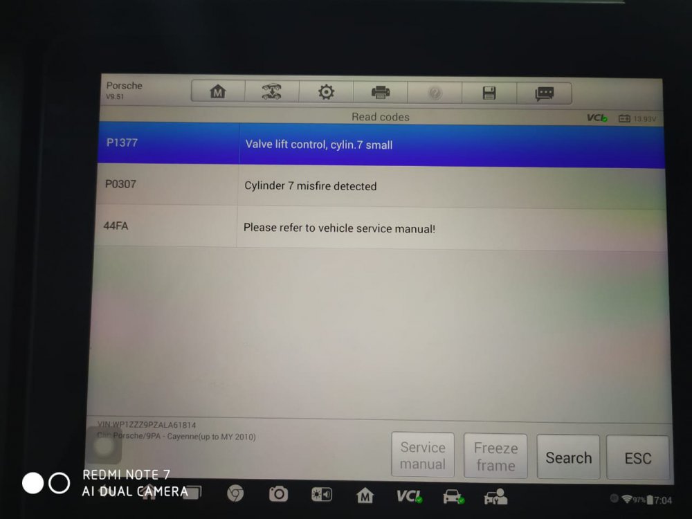

i check OBD its give 3 code
p1377 valve lift control cyl 7 small
P0307 cyl 7 misfire detected
44FA please refer to vehicle  service manual
