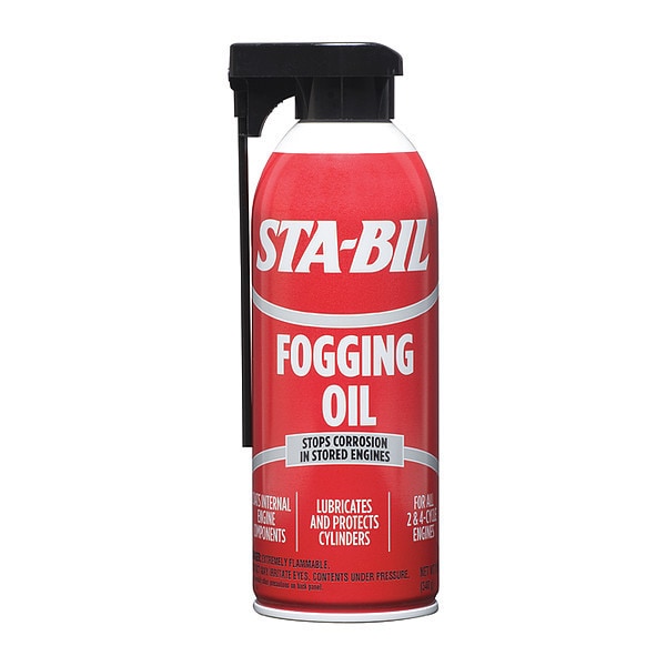

Drain and replace all fluids (including gas), pull the plugs and spray the cylinder's with engine fogging oil, let the car sit overnight, then turn the engine over by had to free everything up. Once loose, put in fresh plugs and light it off, expecting it to smoke a bit at first.
11 minutes ago, Luvchampagne said:
Thank you. Didn't know about the fogging oil. Turning it over by hand makes lots of sense.
Fogging oil is commonly used on long period stored engines to prevent rust and keeps the rings sticking to the pistons over time; cheap insurance. It will also free up stuck rings to prevent any damage to the cylinder liners when recommissioning engines that have been in storage.
