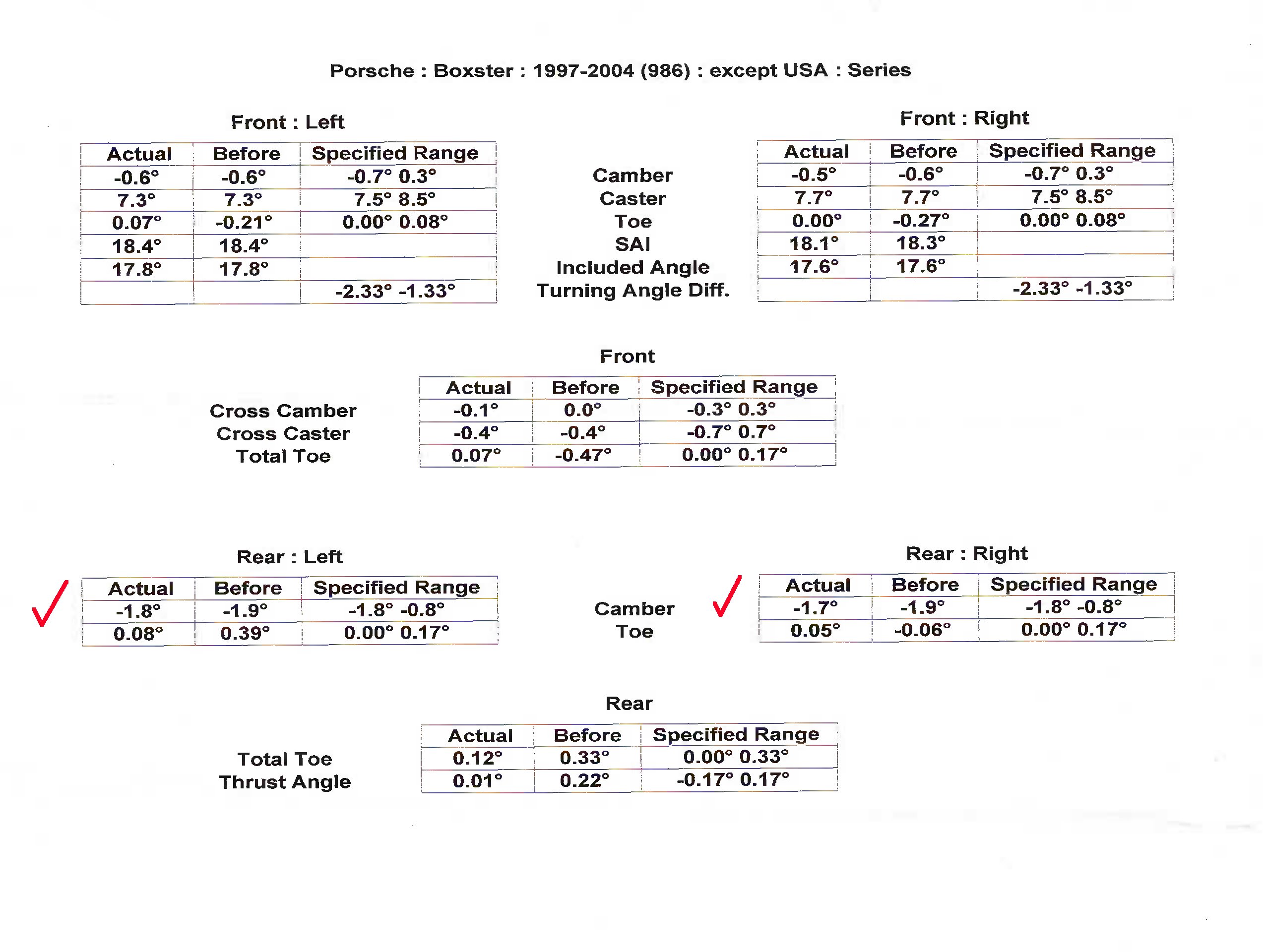

I have a 2000 Boxster S and I have 19" wheels on it and I run 275/30zr19 tires on the rear.  The last couple of times that I purchased tires I have gone thru them extremely fast.  The Michelins that I bought only lasted about 7000 miles, and this last set about 9000 miles.  It's really killing me.
I get a four wheel alignment every time and they set the rear camber within the so-called Porsche Specs (according to the tire shop) which they say the rear camber specs are supposed to be between -1.8°  &  -.8°.  The alignment tech said that he couldn't adjust the camber angle anymore but, he was within spec at -1.7° on the right and -1.8° on the driver's side rear.    This setting is teetering right on the edge of what they say are Porsche specs for my car and there is a noticeable, to the eye, negative camber at the rear.
The car runs great, and tracks well.  The steering and suspension are tight, and it handles absolutely wonderful, but, I am chewing up the insides of these really expensive tires just too fast in my opinion.
So, this brings my question.  If the tech is not able to adjust the camber any closer to a neutral setting, what part or parts do I need to replace to allow for the alignment to get closer to -.8° giving less camber to my rear end on both sides?

Thanks Mike, that kind of went into what I'm dealing with.  But, wasn't very specific.  I think I need new upper control arms, but, I just don't know the whole geometry of the rear suspension either.  That's also kind of what I am looking for.   Looking at the numbers from the alignment tech, is there anything that can be adjusted to stop these tires from wearing out so **** fast.
Also, being on a pretty strict budget right now (some health issues that have cut into my business), replacing the whole rear suspension just isn't in the cards right now.

That's exactly what I need Mike.  I haven't a clue whether or not those numbers are even correct, and I haven't been able to get my rear tires to last any longer than 12k miles.  That really sucks when you're putting Michelins on there.  They cost a fortune.  When I looked closely at the printout they gave me, it says "except USA cars' so, I don't even know if those numbers are correct.
