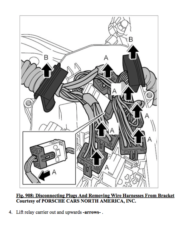

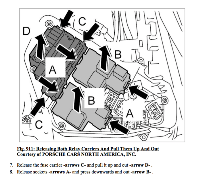

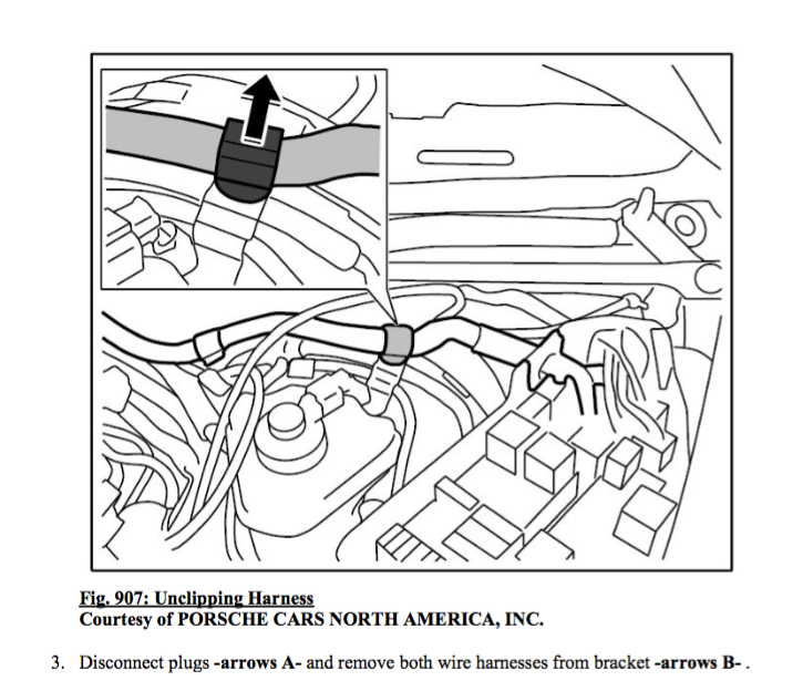

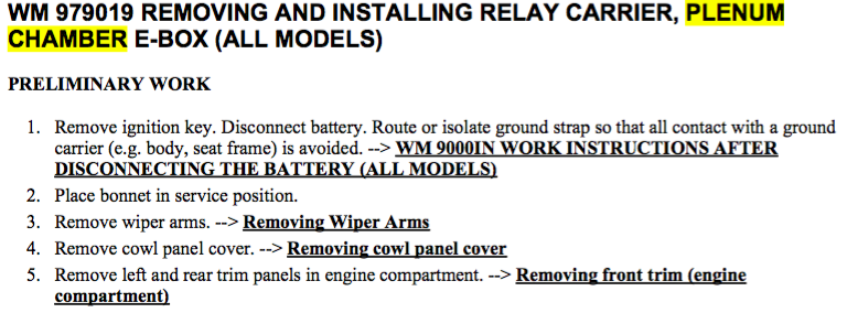

Need to replace the flap actuator and I dont find the procedure 97 90 19 REMOVING AND INSTALLING RELAY CARRIER, PLENUM CHAMBER E-BOX - I have the workshop manual but I can't find the procedure to remove it. I am trying to get access to replace the flap
97 90 19  REMOVING AND INSTALLING RELAY CARRIER, PLENUM CHAMBER E-BOX - I have the workshop manual but I can't find the procedure to remove it. I am trying to get access to replace the flap actuators but I cant find it. I also looked on internet
Trying to post the procedure but exceeded the total file size, sorry
Edited by Rick150
file size
  • Thanks 1
That is not the relay carrier I was thinking. It is to remove the carrier that holds the kessy system and the electric system control unit under the dash. I need to remove this part in order to gain access to the ac flap actuators on the driver side
