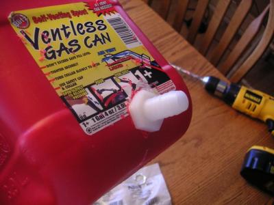

For changing the ATF, I came across this homemade version of the $289 tool or to avoid the $300 charge by the dealer. The link address is
http://tech.bentleypublishers.com/thread.j...=6641&tstart=75

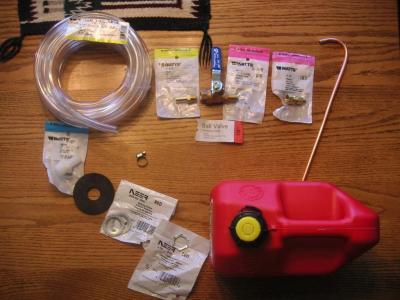

Here are other pictures. I plan on making one in a couple of weeks, will include a part list and BOM. The ATF should be between 90-104 degrees F when installed. A hot summer day with the container in the sun should do it (an inexpensive pool thermometer will do to verify).
Other pics if anyone else is interested:
Enjoy the DIY
