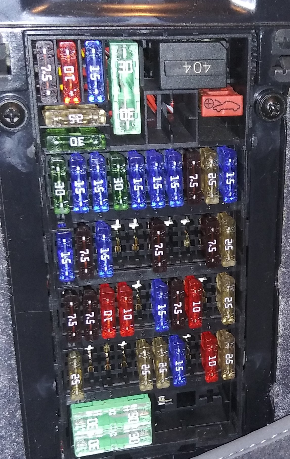

Anyway, I started to attach the pos cable and yanked it as soon as I realized what I had done. I was pretty much scared *****less knowing this is a computerized car. After reinstalling the battery correctly, I started the car, no problems except that it had to re-learn some things and the radio was dead. I drove the car about 10 miles to make sure everything was OK and it seemed to be. I assumed I fried the fuse to the radio (stock) but did not realize the fuse is on the rear of the radio frame. So, I started pulling fuses looking for the radio fuse and to make sure I didn't blow anything else. After finding all fuses intact I realized the radio fuse was not on the panel. I then tried to re-start the car but every single fault alert lit up, brakes, ABS, PSM, etc. and the cooling fan for the front rad came on, I'm sure because an overheat fault was registered. No crank of course.
If I damaged the ECU or sensors, why did the car start and run perfectly? I am *sure* I replaced all the fuses correctly when I went through them and double checked them all a second time. I found the fuse diagram on the web and it looks like I DID replace them all properly. I feel as though I am missing something that should be obvious. Before I flatbed it to a shop I want to feel like I'm not blind to something I should be seeing. Photo of my fuse panel below, in case someone can point out that I mis-placed a fuse. 2008 Base Cayman, Manual, CDR24 stereo

Most likely you have fried some components, particularly the voltage regulator. These vehicles do not like having polarity reversed.  You need to get the vehicle scanned with a Porsche specific tool to see what has happened.
