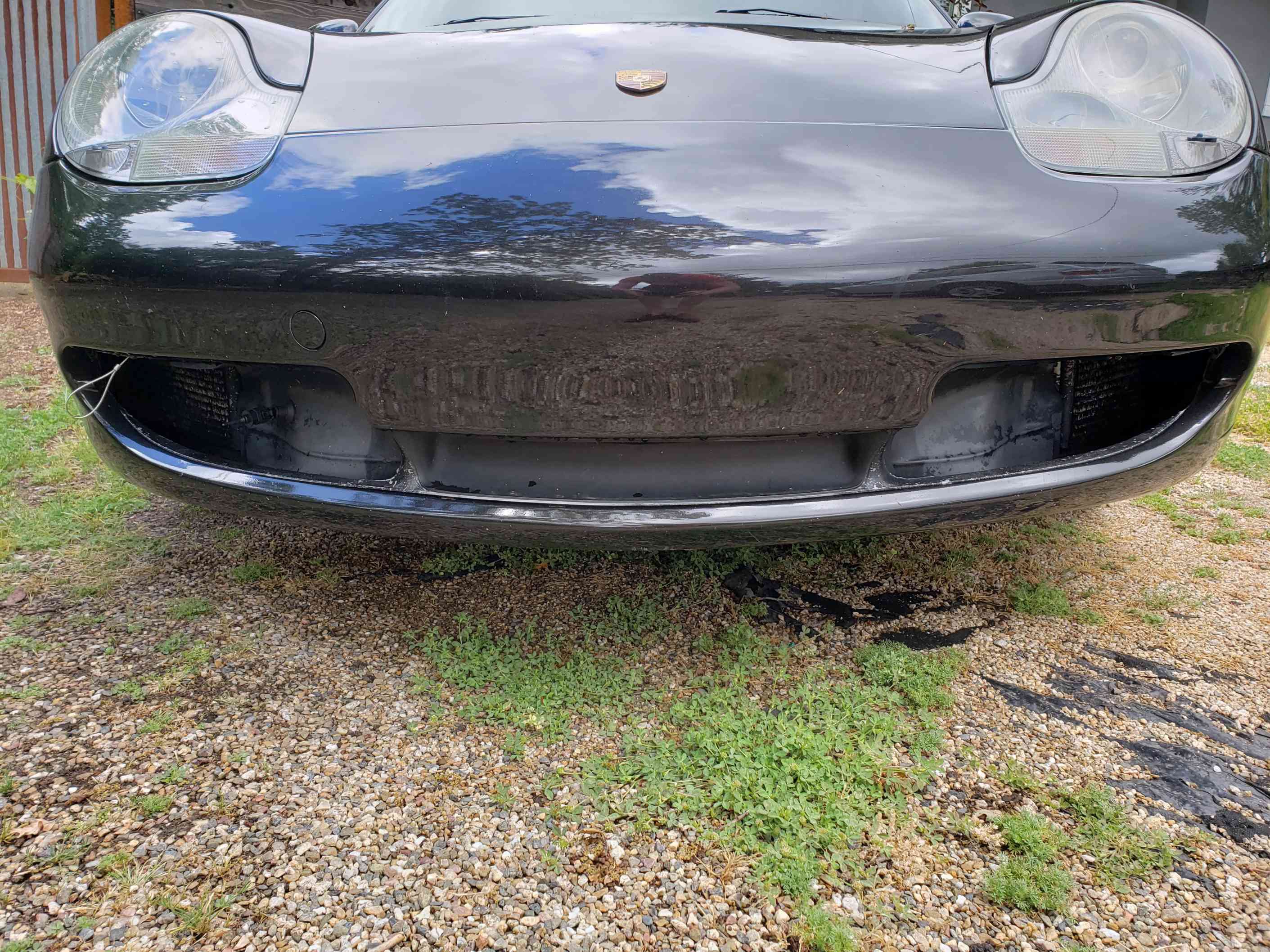

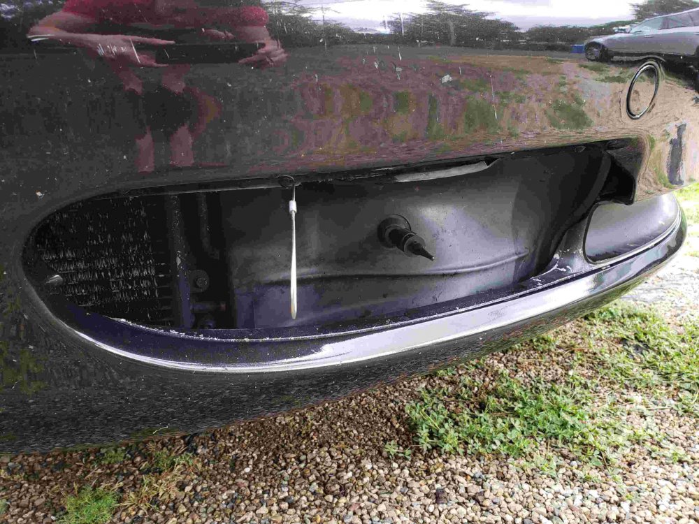

1.     Front Bumper
a.     Bumper insert is missing. It looks like the something was cut out too. I would love to find a used one in Black Metallic.

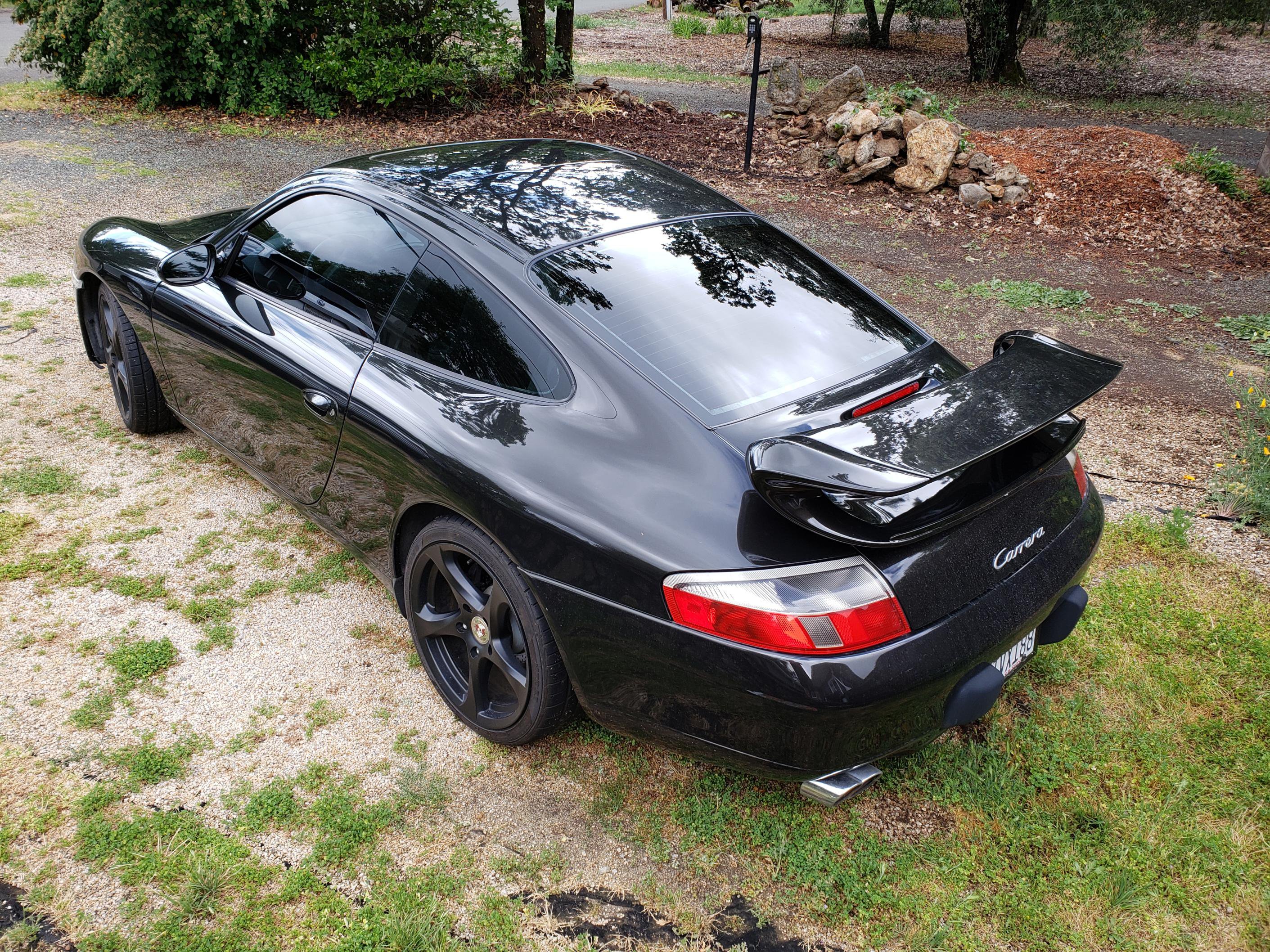

a.     I would love to find a local OEM rear trunk. I would also love to sell my Aero “Taco” wing. Both in Black Metallic.

1. I am not sure what you are speaking of... perhaps a photo?
2. Did the car come with the aerokit package (option XAA). If so, I believe it will be worth a good sum more in a resale as there were not huge number of factory aerokit cars.

1. See pictures to follow

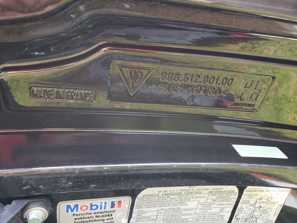

2. This car did not have that option (no side skirts or front bumper). It looks like just the wing was added. MKII maybe? See attached image with number. Does this look like a factory wing? I will include another picture of this wing in a follow up post.
